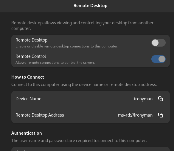

Past few days, I’ve been unable to enable screen sharing. I flip the switch for “Remote Desktop” in settings to the on position and nothing happens.
If I exit the settings screen and re-enter it, the switch is again in the off position (as if I never turned it on):
