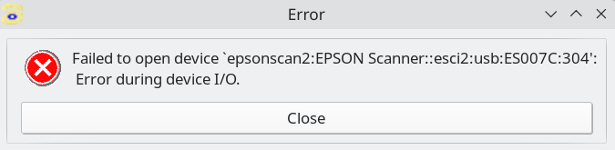

$ scanimage -L
device `epsonscan2:EPSON Scanner::esci2:usb:ES007C:304' is a EPSON EPSON Scanner: flatbed scanner
XSane error…

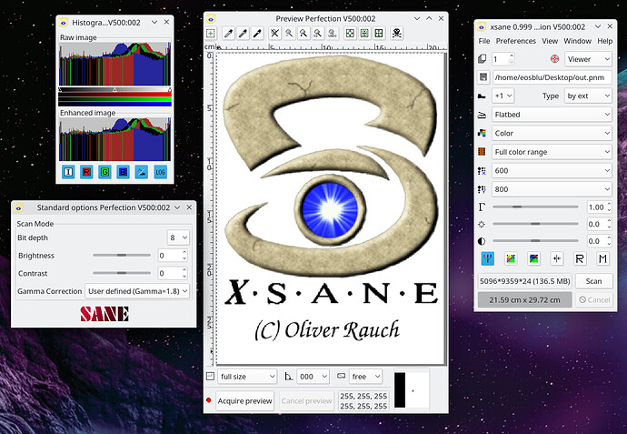

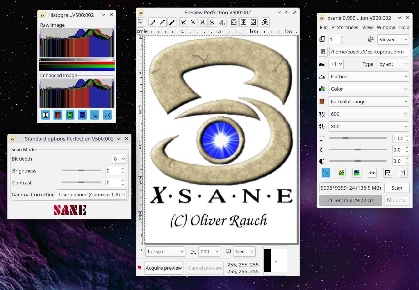

Got it working by installing a V500 plugin (iscan-plugin-epson-v500-photo) that’s available in the AUR.
Epson Scan2 is still not working (won’t open) but Document Scanner, Naps2 and XSane are now working.
advice-
epsonscan2 from AUR=could never see my scanner
esponscan2 from Flatpak=can always see my scanner
I usually stay away from flatpaks but I might try that just to see if it works for me.
According to https://wiki.archlinux.org/title/SANE/Scanner-specific_problems#Epson and https://gitlab.com/utsushi/utsushi your scanner cannot work with Epson Scan2. The working Epson scan program would be iscan
explains why xsane etc sees it. [the arch wiki never fails to surprise me as a catoguer of every linux nuance]
Tried the flatpak version, sees scanner, but still didn’t work on my machine…
