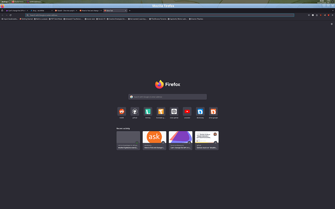

That kind of worked, but now the title bars and everything openbox related is very big and all the apps stayed the same.

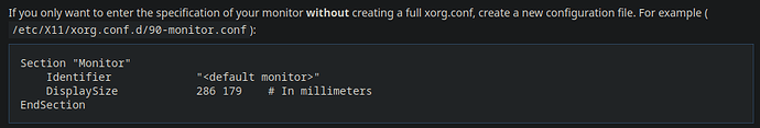

The link you were given has several options to try. What exactly had you modified, and how did you test it?
This is included in the above link/article:
xrandr --dpi 144
FWIW, I would change gtk font size (with lxappearance or similar utility).
Made a file with exactly that name and those contents, then rebooted. Later changed the display name, still same result.

Edit: Now that I think about it, obenbox does scale properly when I do that, the DPI is set correctly now, the apps just don’t really want to comply…
