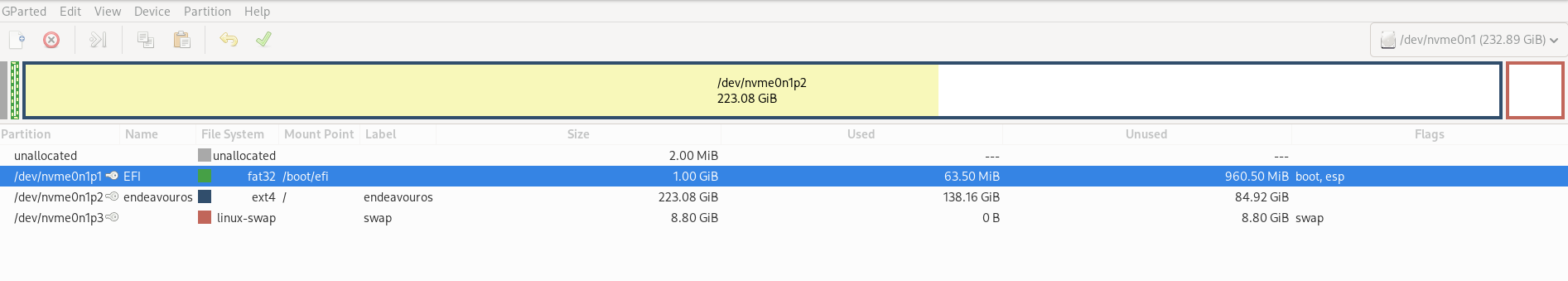

How big is your EFI partition?

1 GiB
Apologies, I meant free space.
960.5 MiB
So it is not an issue.
