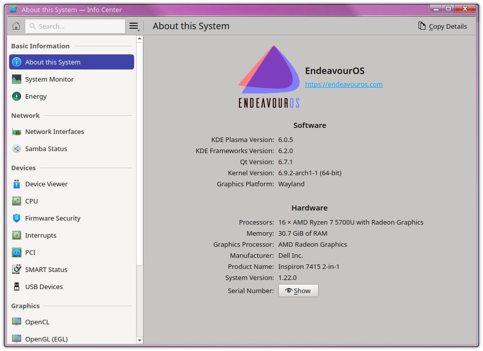

And worked on getting it set up after getting off work today. autofs is crashing when attempting to build, but there’s already someone posted about it on the aur page, so I worked around it.
