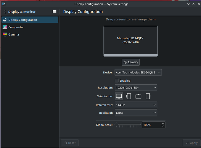

Cannot enable second screen on arch linux KDE 6
Hello, I have been trying to find the solutions for hours and I cannot find it, basically when I go in the kscreen manager setting and enable my second screen it auto disable and display nothing, anyone knows how to fix this?
Did you disable it at some point?
Are you able to click on the enable checkbox? If you are have you made sure to apply the setting after?
@Untreated8054, Have you tried Super + P ?
sorry for the late reply I was repairing my pc which is why I couldn’t respond. I tried super + p without success my second screen does not show no matter what
I clicked on enabled as soon I click “apply” it auto disable itself no ideas how to fix this. Btw sorry for the late reply I was repairing my pc which is why I couldn’t respond.
It just auto disable itself sadly I can’t even enable it.
No problem. Can you try a different cable?
Click Enable, then try moving that MSI monitor. If they overlap it might prevent activation?
Well I tried connecting my second hdmi cable to my first gpu so both screen use the same gpu and it works and I can enable it but it does not works if I connect it to my second gpu. Any ideas how to fix it?. I did noticed some issues like steam proton crashing my game like cs2 but I think its better if I make another thread for it
It seems to be an issue with connecting 1 cable to gpu # 1 and gpu #2 like mentionned above otherwise it works
Ahh dual GPUs, we should have asked for hardware specs days ago. What kind of system are you running?
Run inxi -Fxxx in the terminal and report that info here.

So 2 dedicated pcie Nvidia GPUs? you are sure the powersupply can handly this?
Propritary Nvidia Driver is installed but do you set DRM modesetting in early boot? you may are effected by some latest hickups with the RTX 4060 what could be the reason to not show display … what i said it does not get enough power.
yup my power supply is gold 1000w. it works on windows not linux
1000 Watts should not cause power issues indeed.
yup its there GRUB_CMDLINE_LINUX_DEFAULT=“loglevel=3 nvidia_drm.modeset=1”
edit: idk what happened but now it works, I had this setting for a while seems I forgot to rebuild grub and then rebooting, thank you!
Edit: Here is the command in grub in (GRUB_CMDLINE_LINUX_DEFAULT=): nvidia_drm.modeset=1
