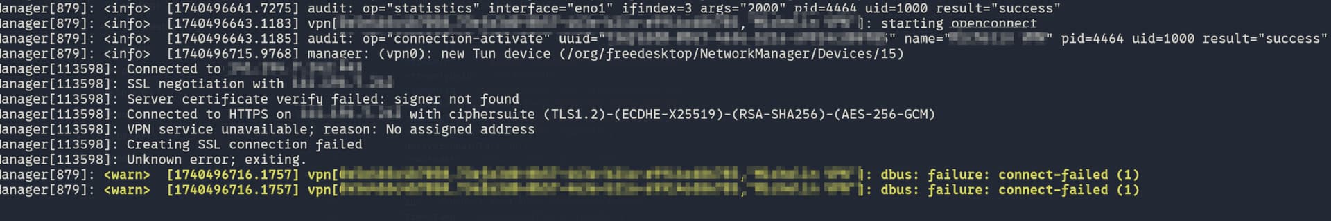

At my work, we need to be able to connect to a cisco AnyConnect VPN. My teammates are using Ubuntu and openconnect. They don’t have any problem, so I followed our internal docs to configure my openconnect settings. I have openconnect and network-manager plugin.
After the authentication was done successfully my host cannot establish a connection with the vpn server and after doing a lot of research seems that my dbus is not configured properly. I tried to do the same with a virtual machine and nothing changed.

Run this to see if there is anything, that shows what goes wrong:
/usr/bin/openconnect --verbose --protocol=anyconnect --dump-http-traffic WhereUwantToConnectTo

And the problem is that the vpn uses a saml authentication and the only way I could authenticate is using network manager for this. Even with that the problem occurs when the tunnel is going to be established and always is due a dbus error.
If it works on another installed computer with ubuntu with your credentials, then the line with:
vpn service unavialable; reason; no assigned address
should be no reason for worrying.

Ran into this problem as well today after doing some firewall upgrades.
It’s not your network card.
Here’s a gitlab issue post that i replied to with what is happening to me and what i’ve tried. Still no luck getting it to work yet though.
