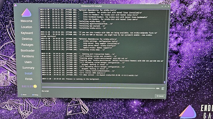

Long story short I borked my install trying to install and decided to wipe and start over but now the installer just hard locks on dkms install nvidia/545.29.06 -k 6.6.2-arch-1
The system is so locked that a simple reset isn’t enough, I have to cold boot.

Booting with the 4090 I must have nvidia installed and if I attempt to install nvidia-dkms it hard locks as shown in those screenshots.

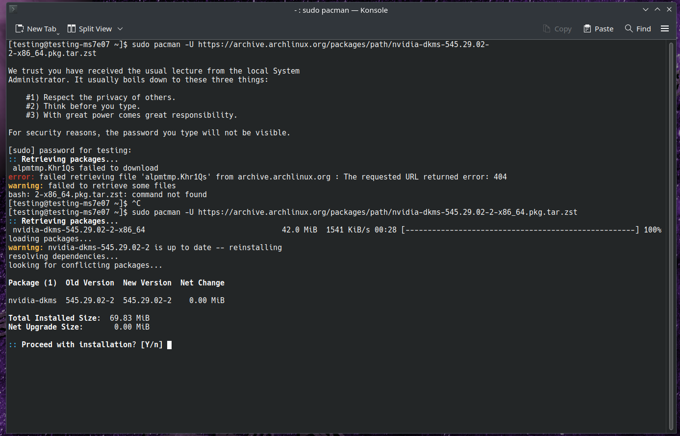

Install offline do not update after first boot and go rebuilding the Nvidia Modules with the package version from ISO.
sudo pacman -U https://archive.archlinux.org/packages/path/nvidia-dkms-545.29.02-
2-x86_64.pkg.tar.zst

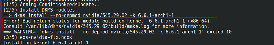

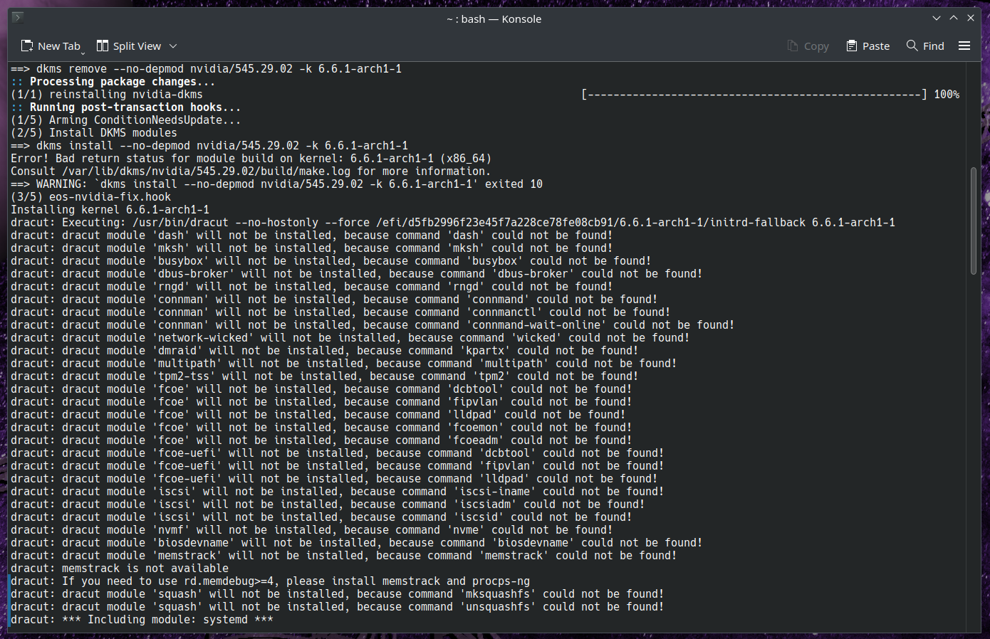

That systemd-boot do not show OS entry is because arch does remove initramfs images when rebuilding… you should be able to arch-chroot and rebuild them.

When I could take a screen shot of the exact error it was throwing CPU microcode errors and the system locks like it was an unstable overclock.
