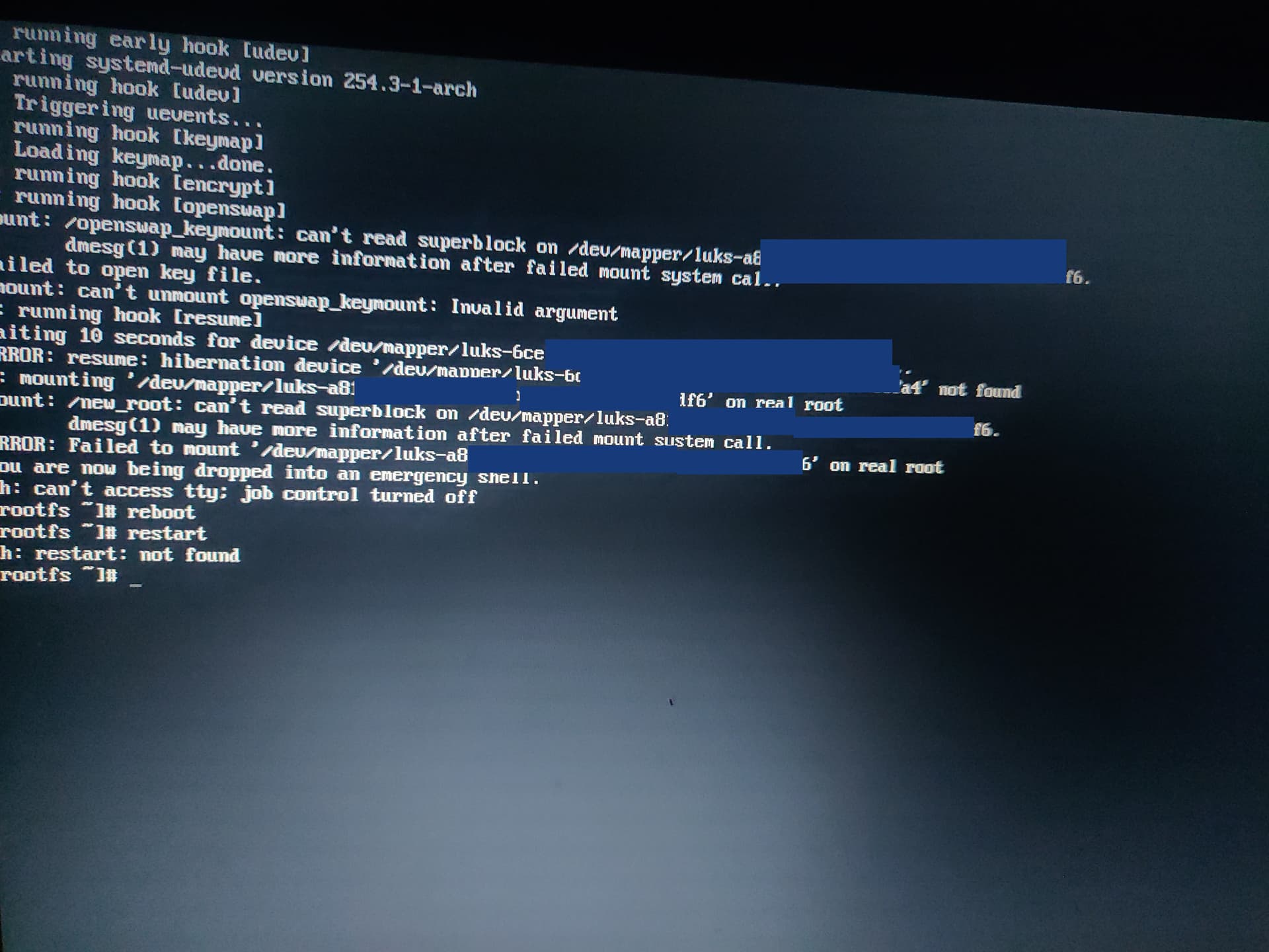

My OS was hanging and nonresponsive, so I reboot it with cold reset. Unfortunately right now I have problem with mounting of btrfs partition while bootin like in the picture.
What should I do?
“Failure to read superblock” usually means you have some kind of disk or filesystem corruption or it is pointed to the wrong device.
I would recommend booting off the live ISO and manually unlocking and mounting the partition to see what exactly is failing.
