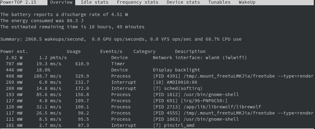

Can the Network Interface (wlan0) be configured for less battery power consumption?
As you see in the screenshot, the Network Interface is the process using the most battery power.
I have seen it peaks anything between 4-4.5 watt at times. I wonder if there may be some configuration to be done to tweak for power efficiency and less battery consumption.
Paradoxically, in my search, I have seen some recommendation to disable power saving for the network interface, arguing that by putting the device into a low-power state when it is idle, this can reduce the transmission power, turning off unnecessary components, or entering sleep modes and therefore if the device frequently switches between active and low-power states, it might consume more power due to the overhead of transitioning states.
Forgive me if I have not got right all the technical details of the matter. I appreciate your comments and to know your opinion about this and possible measures.

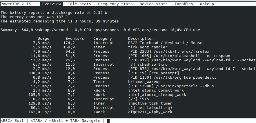

I just installed powertop (2.15-2) on my laptop to see which network interface will consume less power. But even if I unplug the external power adapter, powertop won’t provide me the column called Power est. Now I’m a little bit…hmmpf :face_with_raised_eyebrow:
I guess you’ll have to run powertop -c or powertop --calibrate first otherwise I couldn’t extrapolate the estimates based on power consumption.
That could take a while until finished.
If it is the firs time you start powertop on battery, it has to be run for a certain amount of time to perform a number of measurement on the power consumption of your system before being able to make a power estimation and showing that info.
When you start it in the terminal, it will tell you how many measurement must be done.

My patience got me watching the powerconsumtion of wlan0.
If it’s just connected to my router, doin nothing but be happy, it needs 2.27mW. When watching a video on youtube, it immediately jumps to 4.06W and stays there untill either the video ends or the battery is down.
