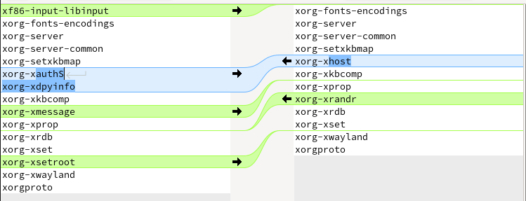

Thanks for this. Here is what I’ve been able to minimize mine to with Gnome:
$ yay -Qq | grep xorg
xorg-fonts-encodings
xorg-server
xorg-server-common
xorg-setxkbmap
xorg-xhost
xorg-xkbcomp
xorg-xprop
xorg-xrandr
xorg-xrdb
xorg-xset
xorg-xwayland
xorgproto
There’s a lot of overlap between the two.
So far I haven’t noticed any applications I use “break”…
Visual diff with Meld:
So xorg-xrandr is actually required by Steam on my machine.
On the other hand xorg-xhost is used by Gnome’s display manager.
Yep I’ve not noticed anything breaking either.
