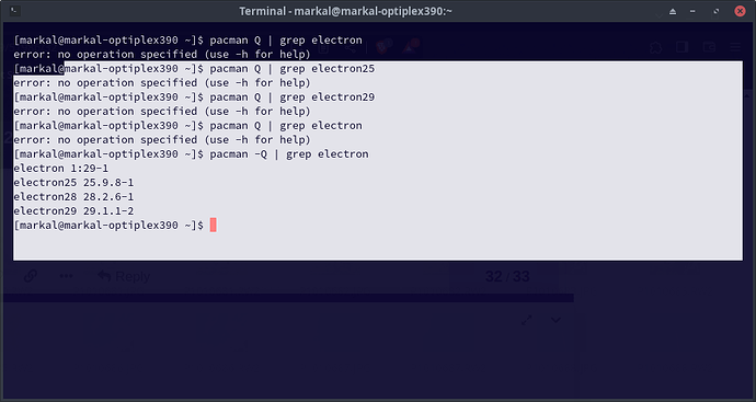

That’s the problem… Unlike on my other machines without the Nvidia card, where I can copy the output from the terminal, that literally fails here. I DID try.
The command was ‘paru’. That’s all.
Best I could do, screen shot. I know that’s bad form.
Just remove the electron packages, then update, then reboot.
What does
pacman -Q | grep electron
say?
Edit: correcting command line
it came back with ‘no operation specified’.
Direct copy and paste of your command into the terminal.
Sorry, my bad:
It’s -Q

sudo pacman -R electron25 electron28 electron29
Then update, if the above command complains, add the name to the command and try again:
sudo pacman -R electron25 electron28 electron29 <next-package-name>
Nothing important uses electron.
