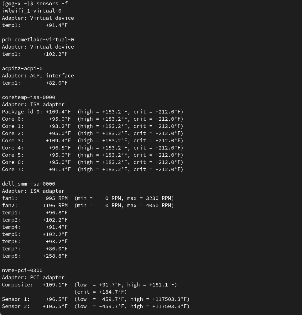

In the dell_smm-isa-0000 section, it shows an unusually high reading for temp8, (see image). Is there a way of identifying that specific device?
The output of
sensors -f
The output of
sensors -f
Not sure how easy it would be to find the actual data sheet for that particular component. However, in looking around I stumbled across this.
That could explain the spurious output…At the same time, in the limitations section, (bottom of the page,) of kernal.org
, (here), it states high temps like my temp8, signifies a bios error, or a deactivated sensor. I am just curious to know if there is really a device connected to that reading.
On that same page it shows a command code that will return sensor type, 0x11a3
that could narrow it down a bit, but I m not sure where, when or how to enter that type of command. Maybe @pebcak can help?
Search inside folder:
/sys/class/hwmon/hwmonX
where X such that
/sys/class/hwmon/hwmonX/name
has content dell_smm.
