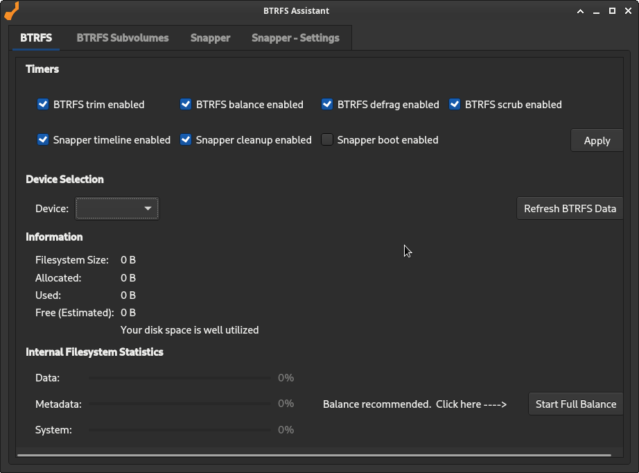

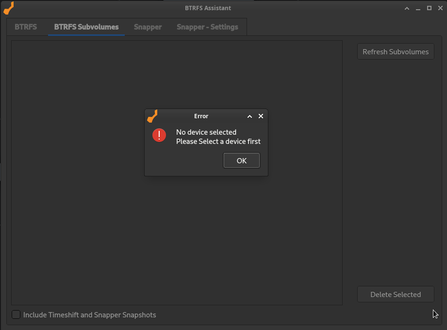

Hi. I’m wondering why is my device part is blank. I can’t select any device, also no device seems under it. And giving me error like this.
Ekran görüntüsü_2022-01-25_12-53-19
Ekran görüntüsü_2022-01-25_12-53-47
Can you share the output of these commands:
sudo lsblk -o name,type,fstype,size,mountpoint
