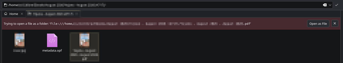

When I click on PDF from Calibre’s main window or click on View it opens up my Dolphin file-manager and shows the following dialog on top of the folder:
Trying to open a file as a folder:'file:///home/shuvashish76/Calibre/Main/Author_name/Book_title.pdf'

To be honest, I don’t really see the problem: Calibre pops up a message asking about the file, then gives you the option to open it. If this is what you want to bypass, then I’d pursue it with Calibre.
I would try using the default calibre package in the Arch repos, just to eliminate that install as an issue.
:face_with_raised_eyebrow: There is no “pop-up message or open_with option” for me.
I’ve disabled “Preferenec > Use internal viewer for > PDF” not to open with Calibre’s viewer.
Edit: Got it, you’ve to “right click > view > view specific format > PDF > open with > choose the application > ok” it works but annoying to use this method frequently. The option is too deep.
Simply click on PDF from Calibre’s “Cover Browser” used to open directly on desired application (in my case Okular) but recently it’s not working due to some xdg-open related issue.
