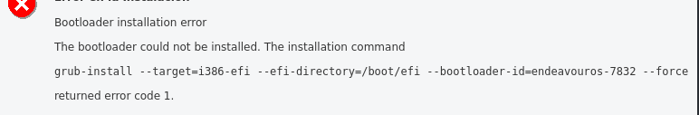

i tried installing then after the bootloader error, in the termial with install-grub and it says:
grub-install cannot find efi directory
tried something to create and mount that directory but probably not doing it right
couldnt install grub…

running lsblk, the root is mounted in a tmp/calamares-root-25345numbers3478
when i try to install grub through terminal after the unfinished installation i cant get any folder to be recognized as efi folder, tried the tmp one, but no, should i change the mount point of that tmp, im a little lost of how to proceed
Can you post the results of lsblk and blkid? An inxi -Fxxxza would also be helpful.
Another thought is to chroot into the installation, add the i386-efi folder and then run grub install. My concern is whether there is an EFI partition or some other problem. The EFI partition needs to be mounted to /boot/efi/ for grub install to succeed. Changing the calmares root won’t fix that, but knowing where root is matters for mounting /boot/efi.
Screenshot_2021-12-13_02-21-50

The partitions appear to be OK. Your EFI partition is mounted at /boot/efi so that is good. The error looks like the grub installer can’t find the i386-efi grub modules.
