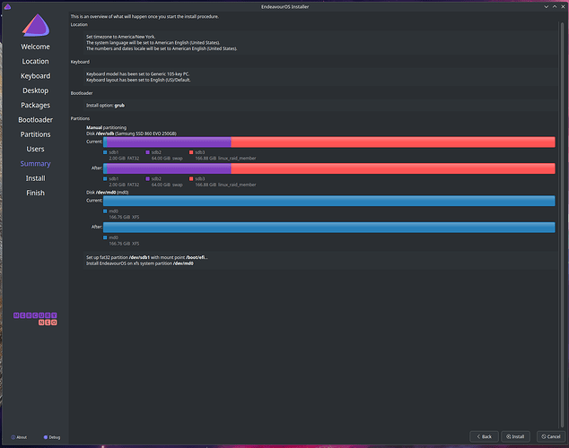

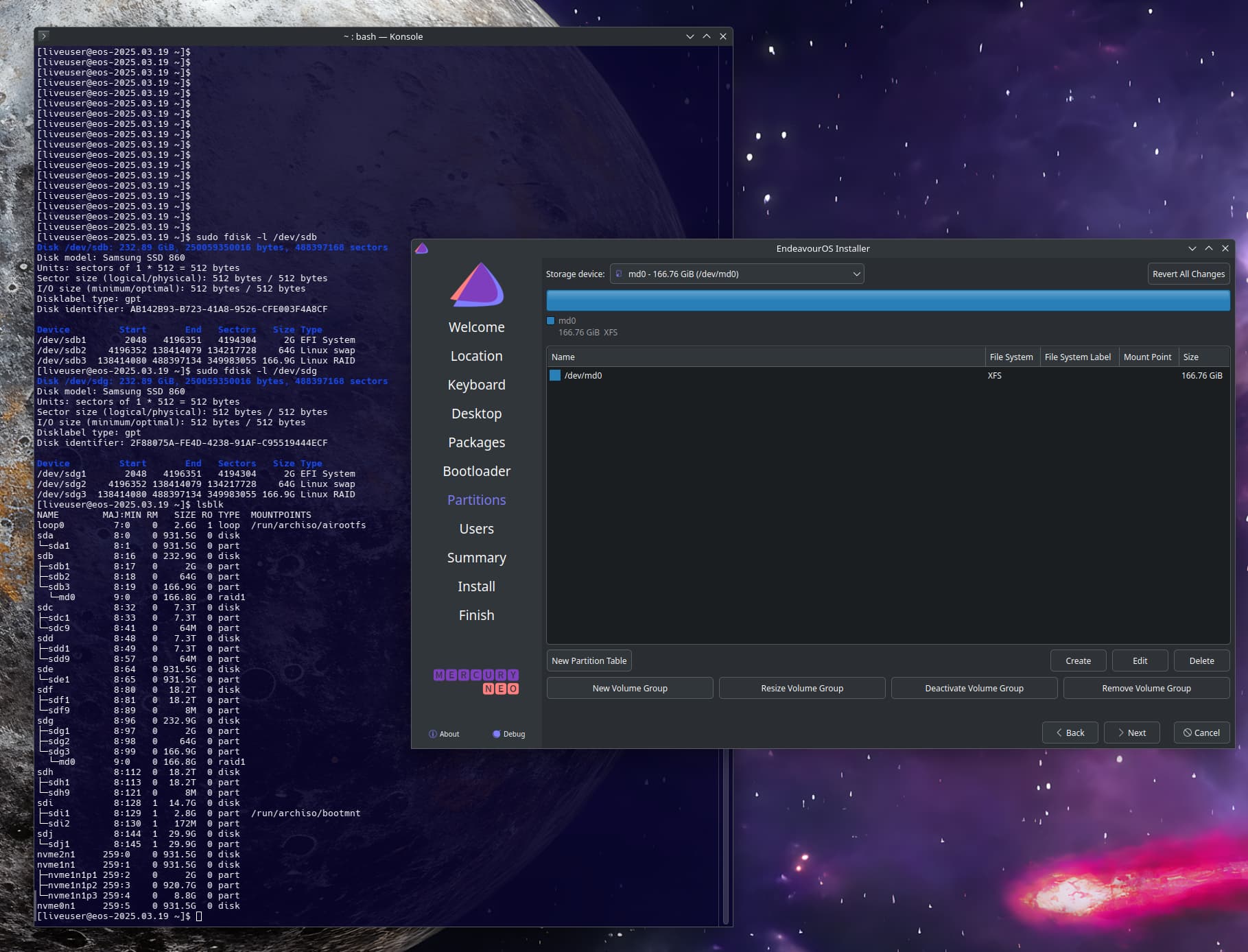

I have a script that seems like it ought to work, but when I run Calamares (online or offline), at the manual partitioning screenm, I only see the XFS-formatted md0, but not the existing fat32 and swap partitions, which means I cannot edit them and manually set their moutpoints.
