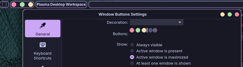

@allewyn ,
My guess is you installed Window Buttons widget and it is missing from panel now.
I reproduced your case in Garuda Mokka. (but I still have the ‘3 dot’ widget on top panel)
I tried to install it in EnOS but failed.
Edit: Succeeded but the procedure was not straightforward enough to attach here.
Super+any arrow will unmaximize your window btw.
