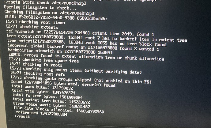

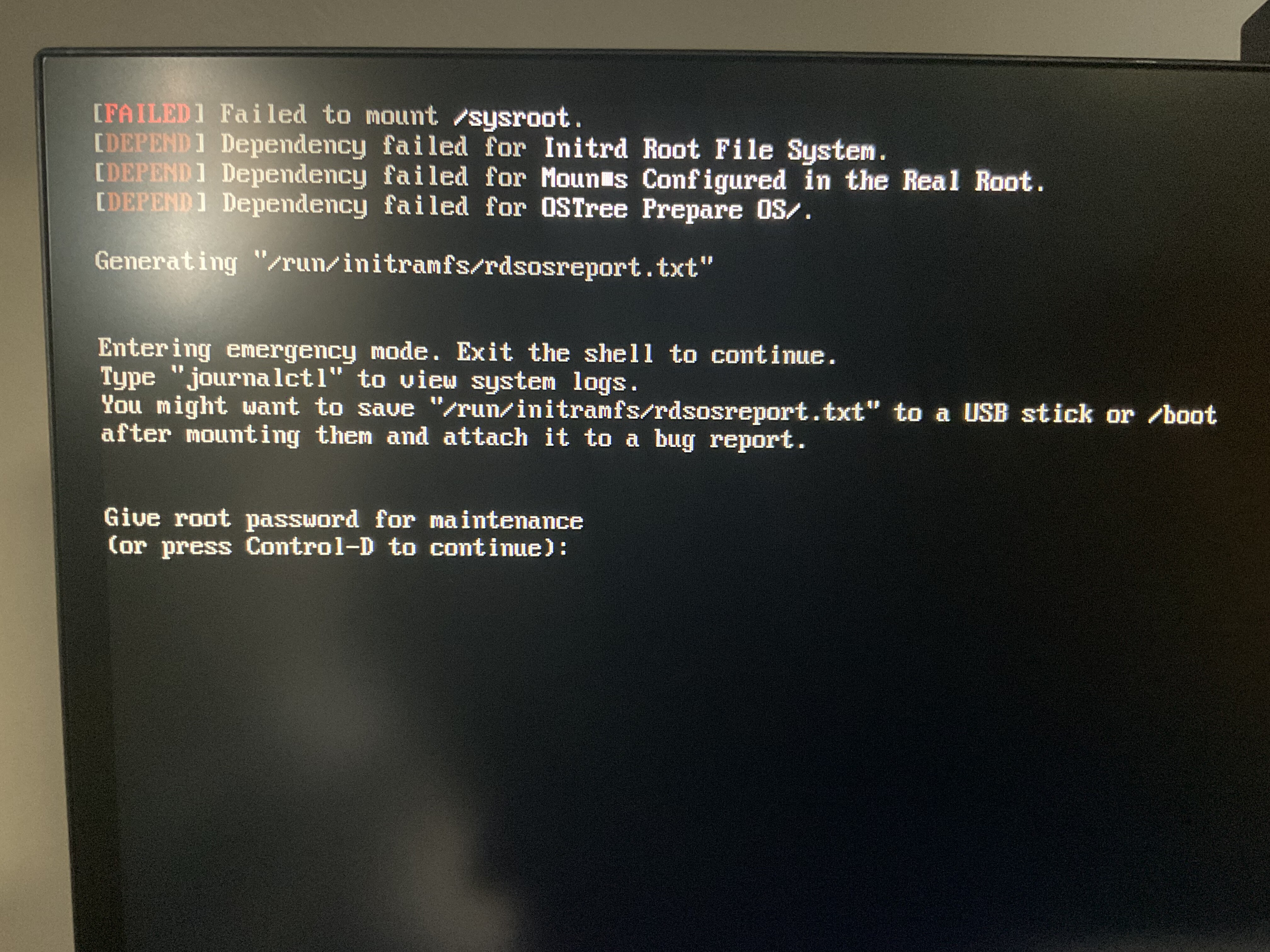

Basically after restarting my system, it won’t boot past grub and I’m presented with the first picture.
I suspect its a btrfs problem due to the dmesg logs.
This persists even when tying with an lts kernel or any btrfs snapshots that were previously created.
Also I tried booting from a live system to run a btrfs check and repair however I’m unable to even mount the partition. (Running a check with gparted also doesn’t work)
Any kind of help would be much appreciated as I’m stumped and in the middle of uni exams.

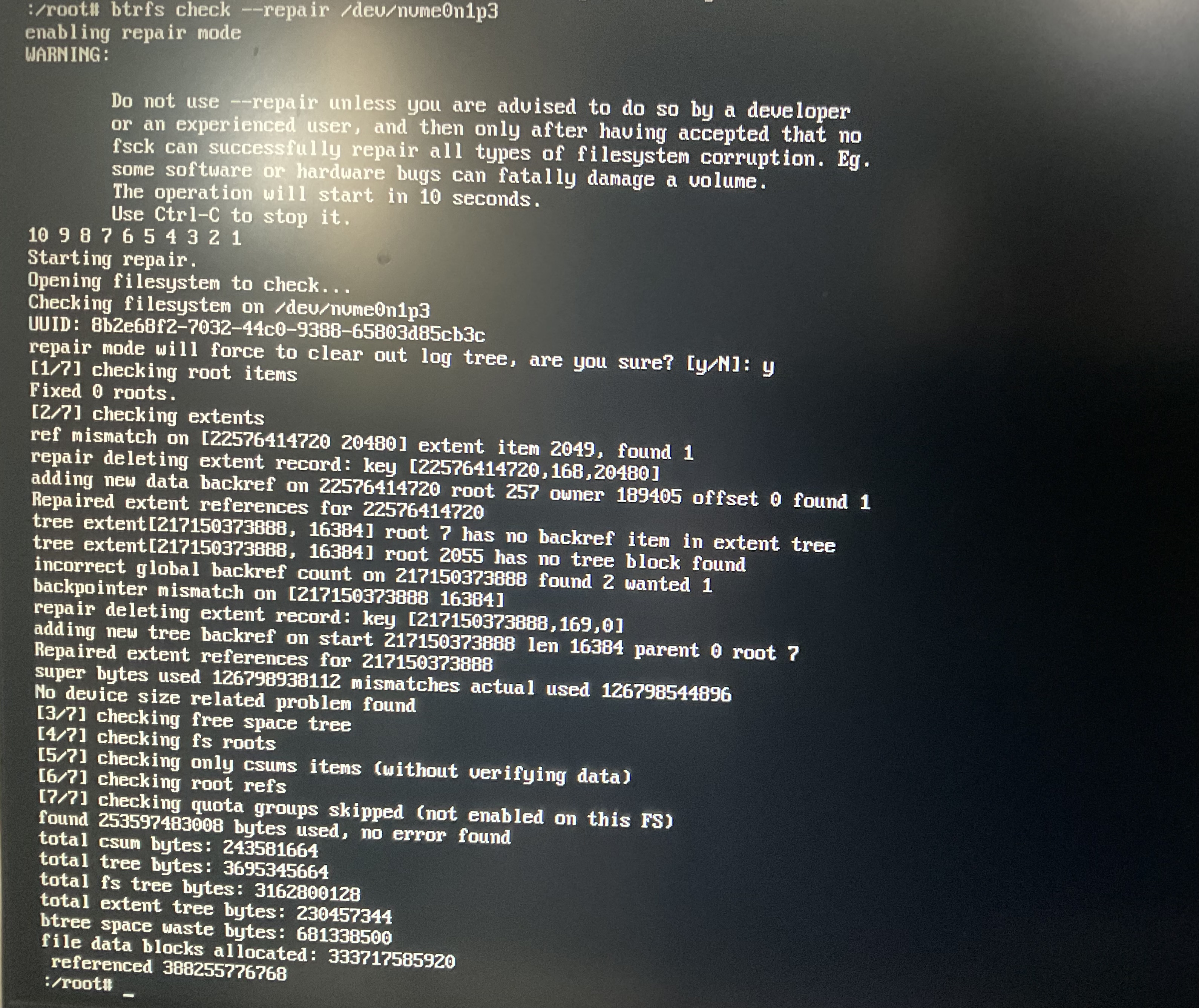

Ok so I went along with it as I couldn’t manage to mount the partition and any important data was stored on another drive.
After running the repair I typed exit and it some how put me onto the sddm login screen where I was able to start kde.
However is there a way to check if there’s still any existing errors or the cause of this?
You can run btrfs check to see if there are still errors.
As for what caused it, it is hard to say. The most common cause is power loss while the device is mounted. This can happen by hard power off(holding the power button) or losing power some other way.
It can also be caused by hardware failures, most commonly with the disk itself.
