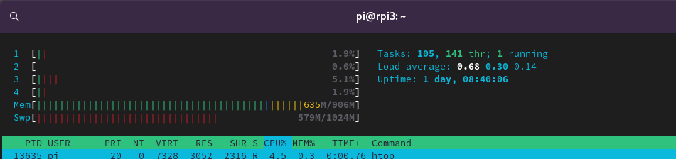

zwap saved my raspberry pi 3b, which has only one 1GB of RAM…
Ubuntu for raspberry Pi doesn’t have a swap by default, so I created one and enabled zwap.
So, in this situation, more life to old devices…
This works for raspberry pi 3b too:
https://ubuntu.com/blog/how-low-can-you-go-running-ubuntu-desktop-on-a-2gb-raspberry-pi-4
Zswap is not really swap, it’s a mechanism that reduces the usage of real swap, by compressing rarely used pages and then deciding whether they need to be swapped or whether they can stay in RAM. Compressing a memory page is typically much faster than writing it to disk, but requires more CPU use, so you trade CPU cycles for more efficient memory usage and less swap. But you still need a proper swap file or a swap partition. The only difference is that it will be used less if you have zswap enabled.
On Arch Linux, zswap is enabled by default on all kernels from the repos.
For this situation, it is helping a lot…
I was almost decommissioning it when I decided to try the zswap path, and more than a year now, it remains in use :slight_smile:
I’m running:
Apache with php module
Samba as a domain controller in which my NAS is a domain member.
Freeradius for wifi network using samba users database, with post-auth rules based on groups.
Unifi controller with java 17 and mongod 3.6.8, which manages two devices, unifi mini and a unifi nanoHD.
Really a lot for 1GB of ram…
