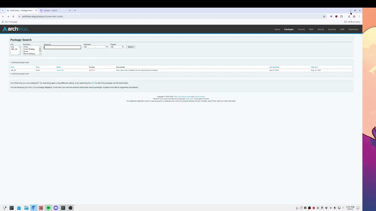

Im kind of new to the Linux world and installed eos with kde and wayland. Everything works so far. Except that annoying overlapping window when making the browser smaller. Can someone help me fix this?
I tried to switch to X11, but does not help. Changed to stock kde themes cause i thought that was it.
Look at my recording. The right side is a part of the second monitor and you can see the overlapping.
2 Monitors running 1440p on 120hz. Both with freesync.

Good call. Gave it a try and added a standard user. Still the same thing happens. The weird part is, its only happens on a internet browser like chromium or firefox
for example system settings window does not do that
Edit: And it does not happen the other way…so if I change window size on the right monitor it does not overlap to left monitor
Watching the bottom Plasma panel, it seems the window is correctly maximizing.

The recording is my main monitor and part of the second monitor (only a part of the second to see better in the recording).

Guys…i changed the animation speed to a little faster and that seems to fix my issue.
