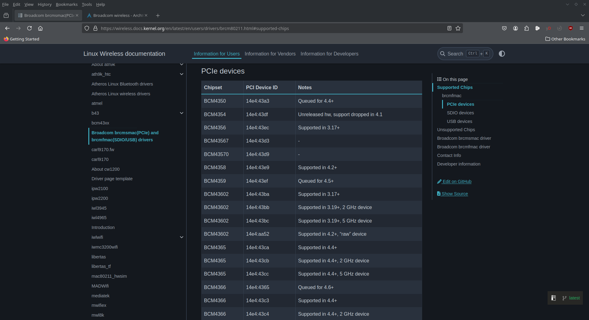

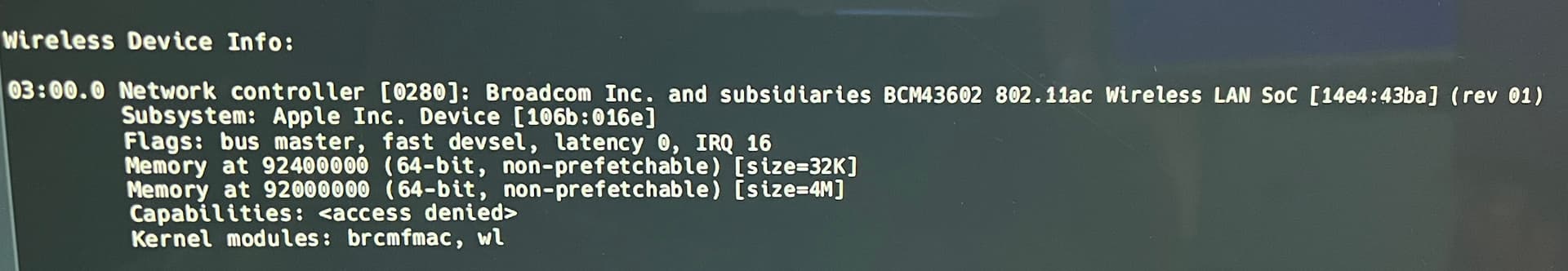

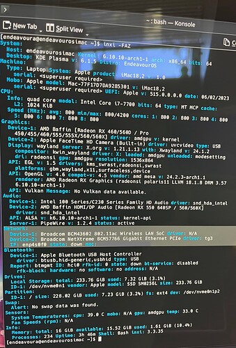

I ran the ‘$ lspci -vnn -d 14e4:’ command in the terminal and found out what wireless driver I would need (I think), which is the brcmfmac driver. I went to URL https://wireless.docs.kernel.org/en/latest/en/users/drivers/brcm80211.html#supported-chips, and did some poking around there, which then led me to the index : kernel/git/firmware/linux-firmware.git webpage. I believe I have downloaded the correct brcmfmac driver (linux-firmware-ea1178515b8852a5ead23b165b4609ef2b49f36c.tar.gz), but beside using the sudo command, I’m not not sure exactly how to install it.
Also not sure if I need to install an additional ‘wl’ driver along with the brcmfmac driver as well. I have included some driver pics for my setup below. Thanks for any assistance in advance…

Edit: I just checked and it looks like that chip does use brcmfmac.

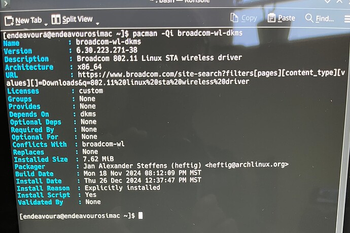

Thanks for your response. So, I found out that broadcom-wl isn’t installed and broadcom-wl-dkms is. When I ran pacman -Qi broadcom-wl-dkms in the terminal, it showed the following Conflicts With : broadcom-wl. I went to /etc/modprobe.d/broadcom-wl.conf and added blacklist broadcom-wl (saved the file with Admin). I am still unable to use Wi-Fi.
I went and installed the broadcom-wl-dkms driver (broadcom-wl-dkms-6.30.223.271-38-x86_64.pkg) using the following command sudo pacman -U broadcom-wl-dkms-6.30.223.271-38-x86_64.pkg. It went and installed the driver, but I still can’t use Wi-Fi.
I restarted the computer and ran nmcli device wifi list, nothing. I then tried nmcli device wifi rescan, still nothing. Am I still missing a step, or doing something wrong? Should I go ahead and uninstall broadcom-wl with sudo pacman -Rn broadcom-wl, and leave it blacklisted? Thanks.

Ran pacman -Qi broadcom-wl-dkms. broadcom-wl-dkms is still showing a conflict with broadcom-wl.

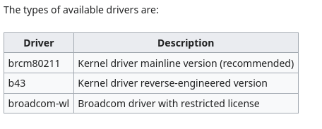

Edit: Some of the macs or imacs use the broadcom package as they are proprietary. Then there is also the legacy.
https://wiki.archlinux.org/title/Broadcom_wireless
I just looked at what chip it has and as far as I can tell it should use the brcmfmac. :pray:
