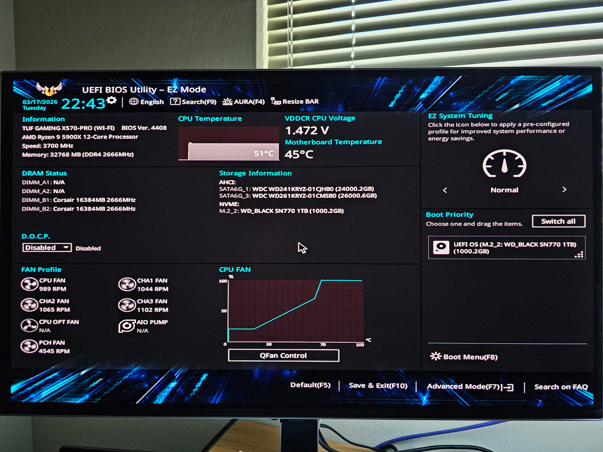

Good evening all,
When booting up my computer now, I am consistently going straight into the BIOS, the view of which I have attached in the first screenshot. The basic motherboard and CPU models are in the upper left. It seems that my storage volumes and the SSD with EndeavourOS are identified, but even after adjusting various settings, and even trying restoring BIOS settings to default, I am not able to boot into my OS. On Sunday I was in the middle of an eos update when I restarted my computer, and this issue first occurred on startup right afterward so I suspect I may have screwed something up by doing so, and the partition with my OS may not be mounting properly. If there is more information I should provide about my specs, or the situation at hand, I will gladly do so, and I am happy to take the time to learn what I need to in order to resolve this issue. If there is anybody on the forum who can offer insight into the problem, I would greatly appreciate your help. Please be patient with my inexperience. Thank you in advance.
Best,

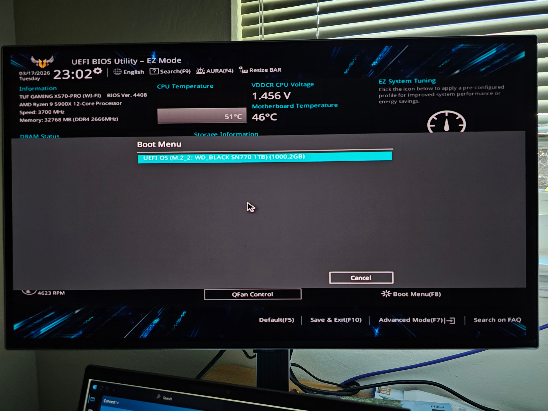

Please show the output of
efibootmgr -v
Thanks, @mbod. The output of efibootmgr -v is below in the blockquote.

Ok. The formatting is horrible. You need to start using the formatting function in the forum editor. I dont know if a tutorial exists for this.
Anyways, the Boot0001 entry shows just a generic fallback boot manager:
What it should look like is something like this:
Boot0000* Linux Boot Manager HD(1,GPT,1476f27b-f73c-4564-8510-b510e563e95c,0x800,0x100000)/\EFI\SYSTEMD\SYSTEMD-BOOTX64.EFI
This is how the systemd boot entry should look like.
I suggest you reinstall the systemd boot entry with:
bootctl install
Of course this should happen in an arch-root environment with the proper boot device mounted to the right folder.
You arch-chroot into your installation. Check in /etc/fstab which partition (vfat) needs to be mounted to which folder (e.g. /boot or /efi). mount it and do the bootctl install. And then keep your fingers crossed that it boots.
