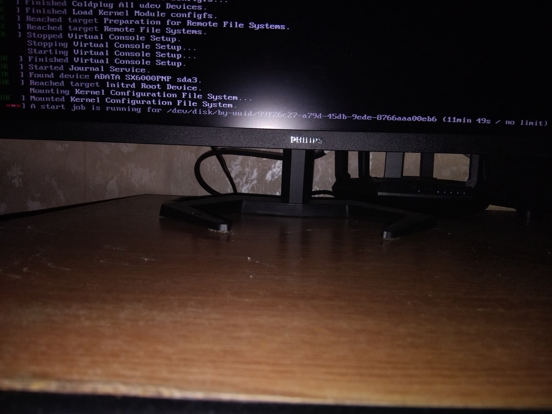

Boot stuck at a start job is running with no time limit, resume=UUID
Hello World,
Aaahhh crap, help, so I deleted me old swap partition and created a new bigger one and while I modified fstab to put the uuid of this new parition I probably did it wrong cause now it’s stuck on boot, I’m guessing still trying to mount the old partition… So any way I can tell it to boot without mounting that uuid so I can try to fix my mistake?

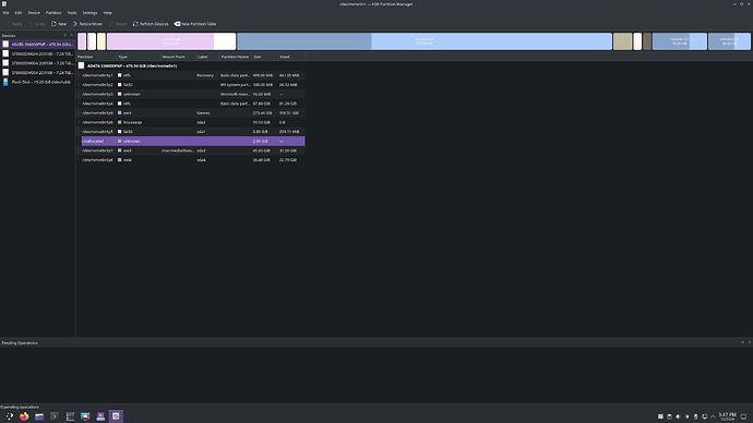

Here’s how things looked before in partition manager(except that giant bloob of unallocated space is now a new ext4 games partition)

And this is how the partitions look now, as you can see I deleted the small 2gb swap one I had before, took some space from the big games partition and created a new swap.

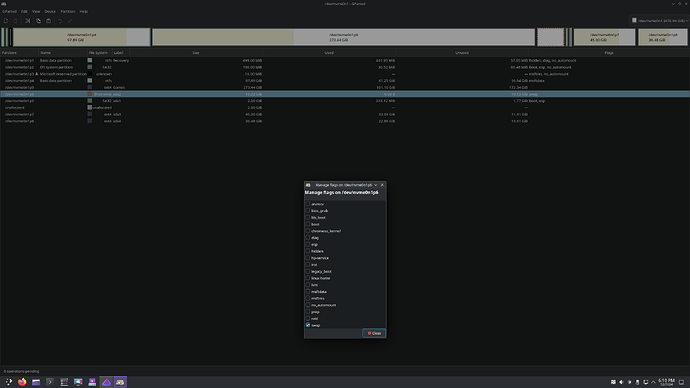

when you created the swap partition did you flag is as swap?

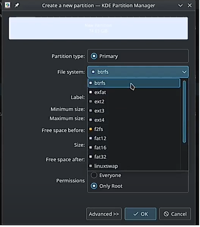

Yeah, here’s a screenshot of what it looks when you create a new partition in KDE partition manager that I took from a video I found on youtube.
I selected linuxswap, though now that I think about it I don’t think I selected anything at permissions and I don’t think anything was selected by default like in this picture. Could that be the problem?

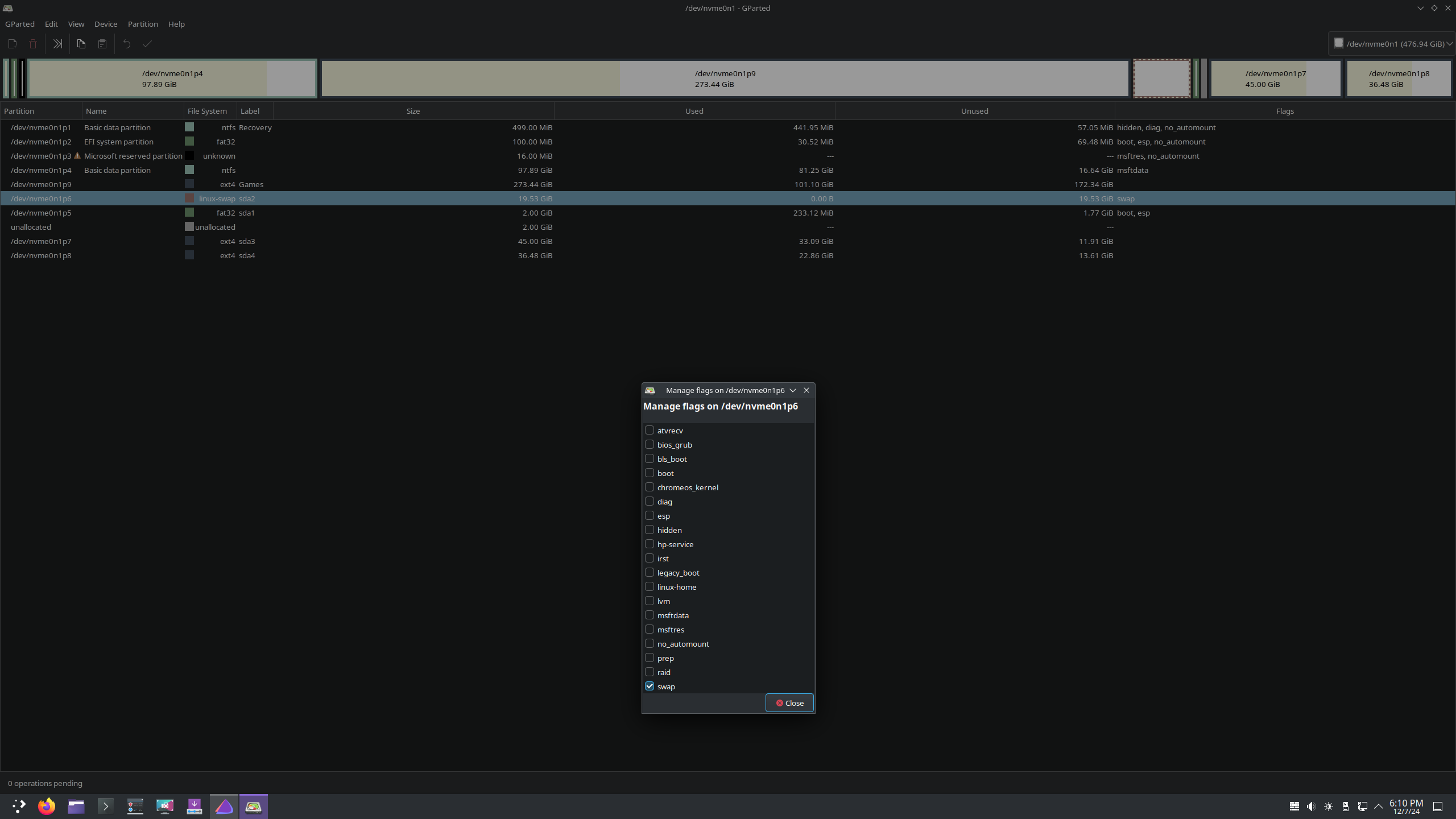

ok we are not discussing the same thing. that looks like the file system I’m talking about flagging the partition as swap. Not sure about KDE as I don’t use it but in Gparted you can right click the device and choose manage flags and select swap from there. However I’m not sure that is the issue I think I can see the picture a bit better and your still calling the uuid of the old swap.

Ok, booted from the usb stick, here’s how it looks in gparted:
Not sure how clear this is, but here is a short video, I press e, delete the resume=uuid in question the one that ends with aaa00eb6, then press enter.
As for shutting down the pc and waiting, yeah I did wait, 2 mins or so maybe…
LE: I know it was probably useless/futile but out of curiosity, just to see what would happen, I tried 2 more things. First I edited the fstab file and removed the entire swap line. Then I replaced it’s contents with the ones from the old fstab file(the one that has that aaa00eb6 uuid).
And it didn’t matter, in either case crazy linux is still trying to resume that uuid. Please please please don’t tell me I have to reinstall linux!!!.. :sob: :sob: :sob: :sob: :sob:

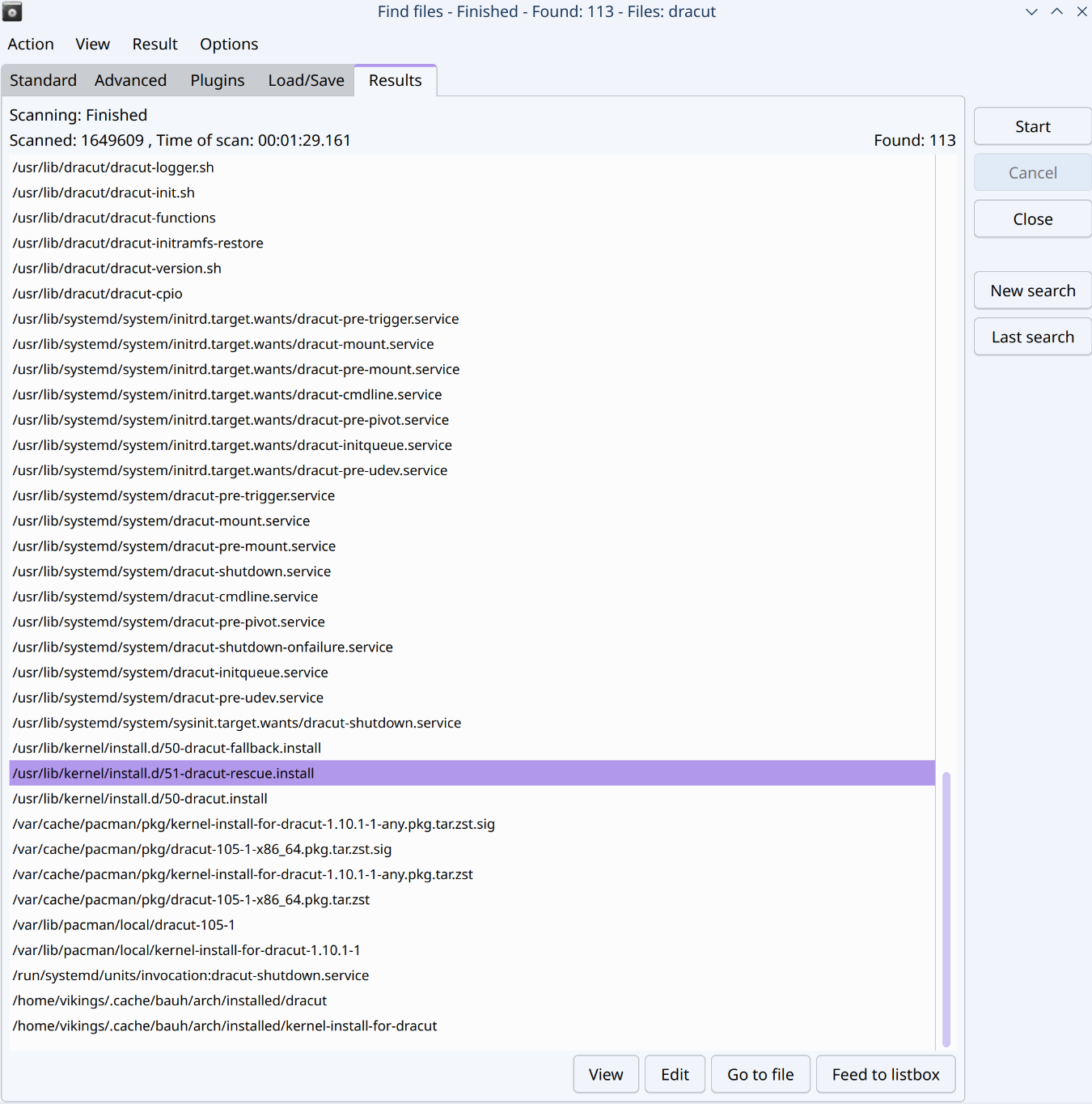

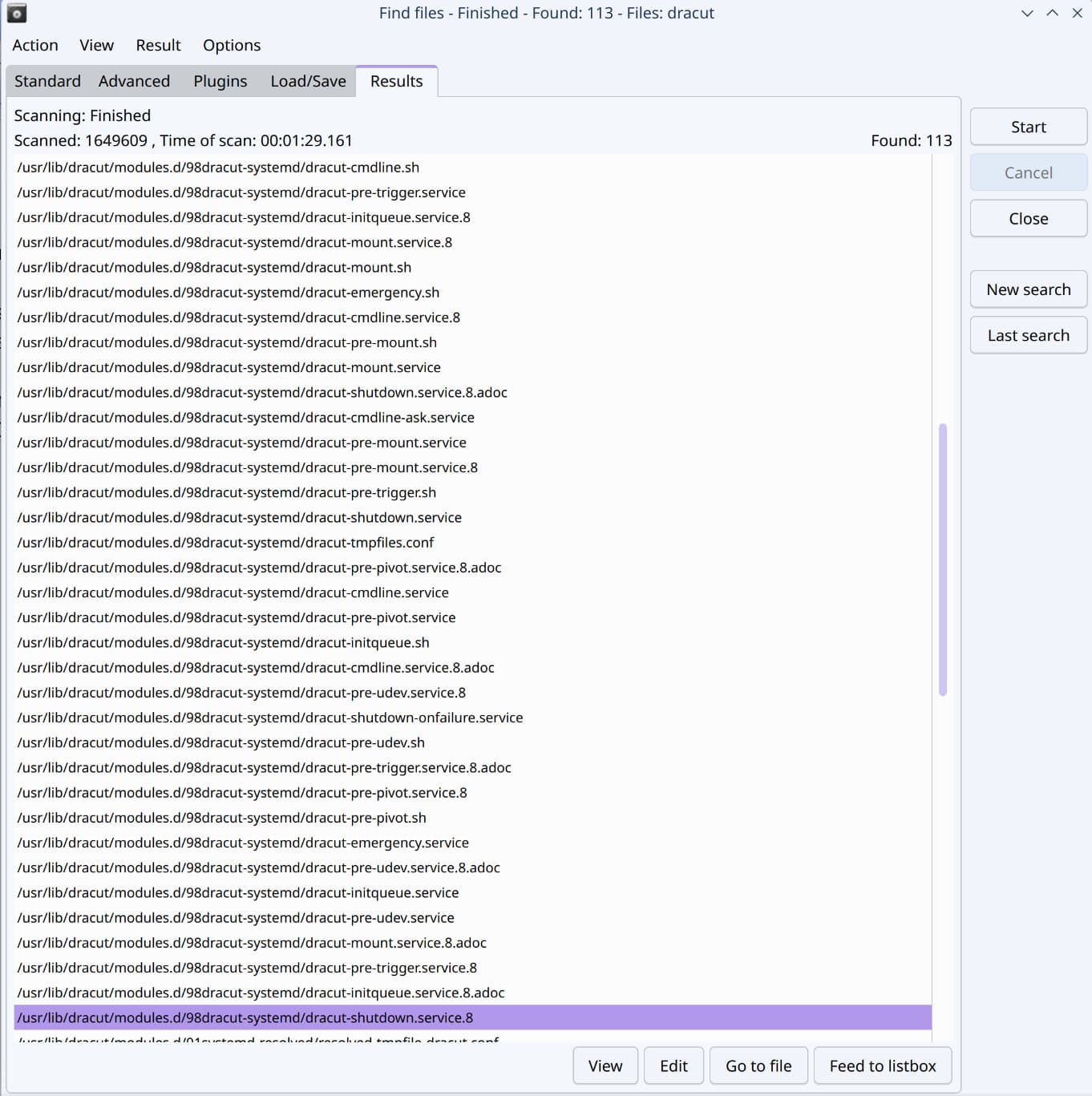

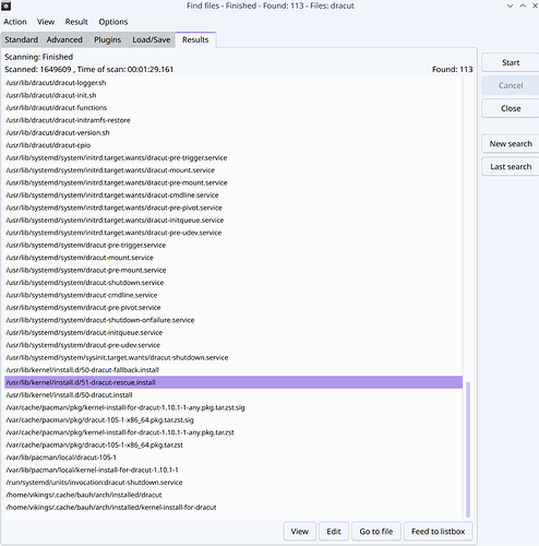

Uuummm, ok just to make sure I don’t mess things up again, I don’t have a grub folder in my /.

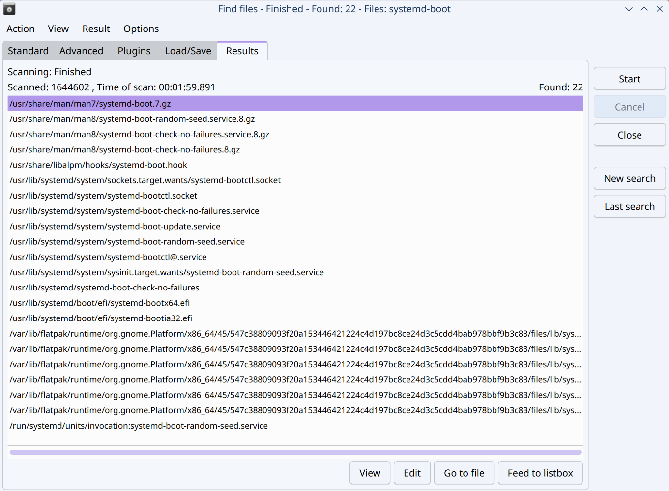

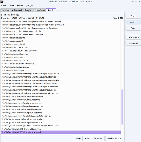

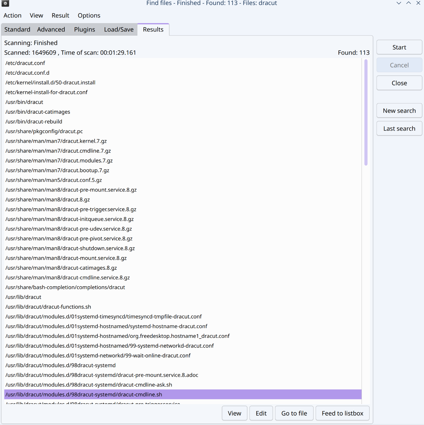

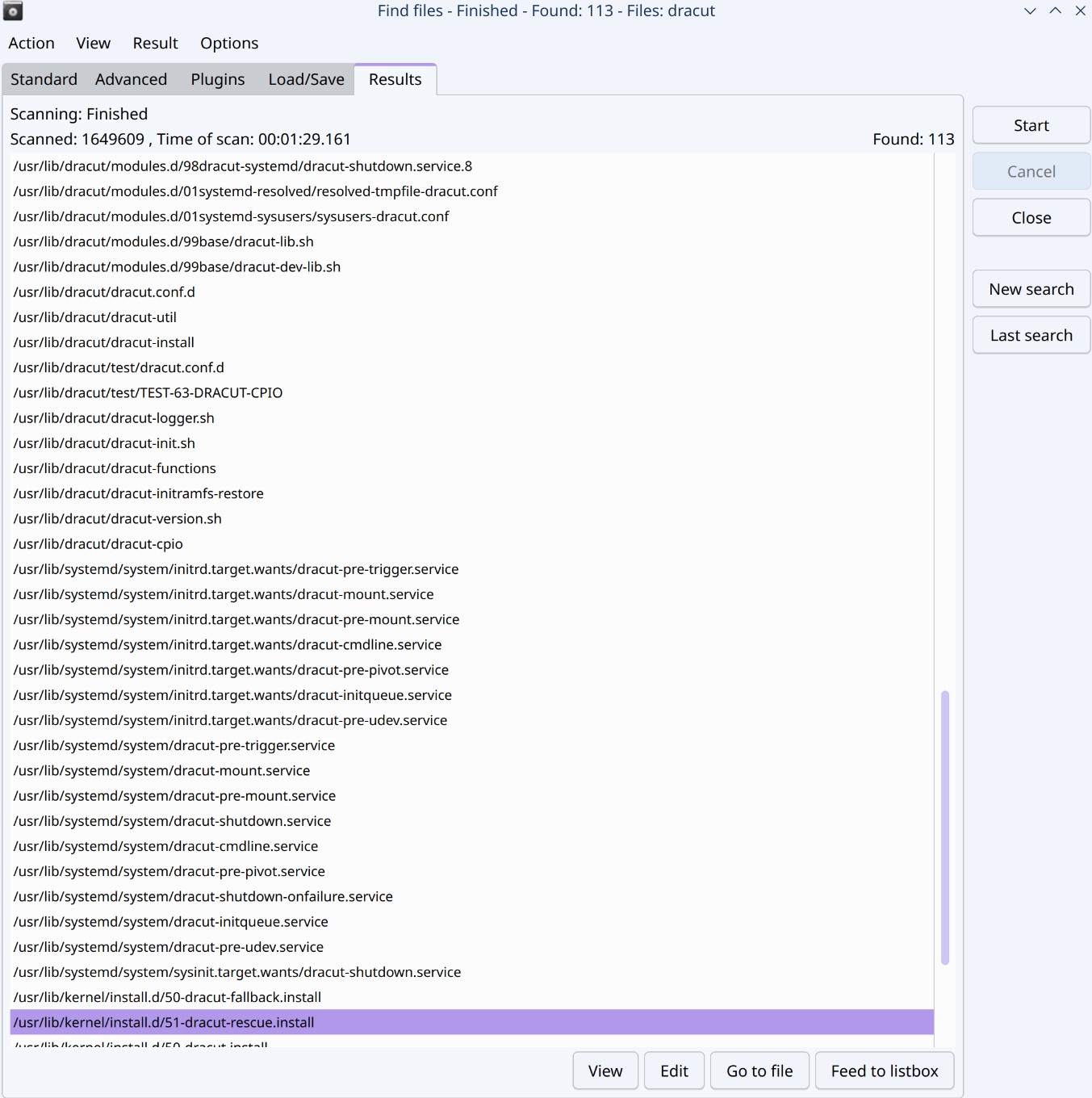

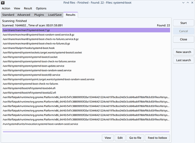

So I did a search for systemd-boot and dracut and this is what came up, which of those files exactly are you talking about?
if your using systemd-boot
try in the efi folder
/efi
I don’t have a swap partition I just use a swap file. but it should be in a conf file
remember you have to edit the file with root so make a backup before making changes

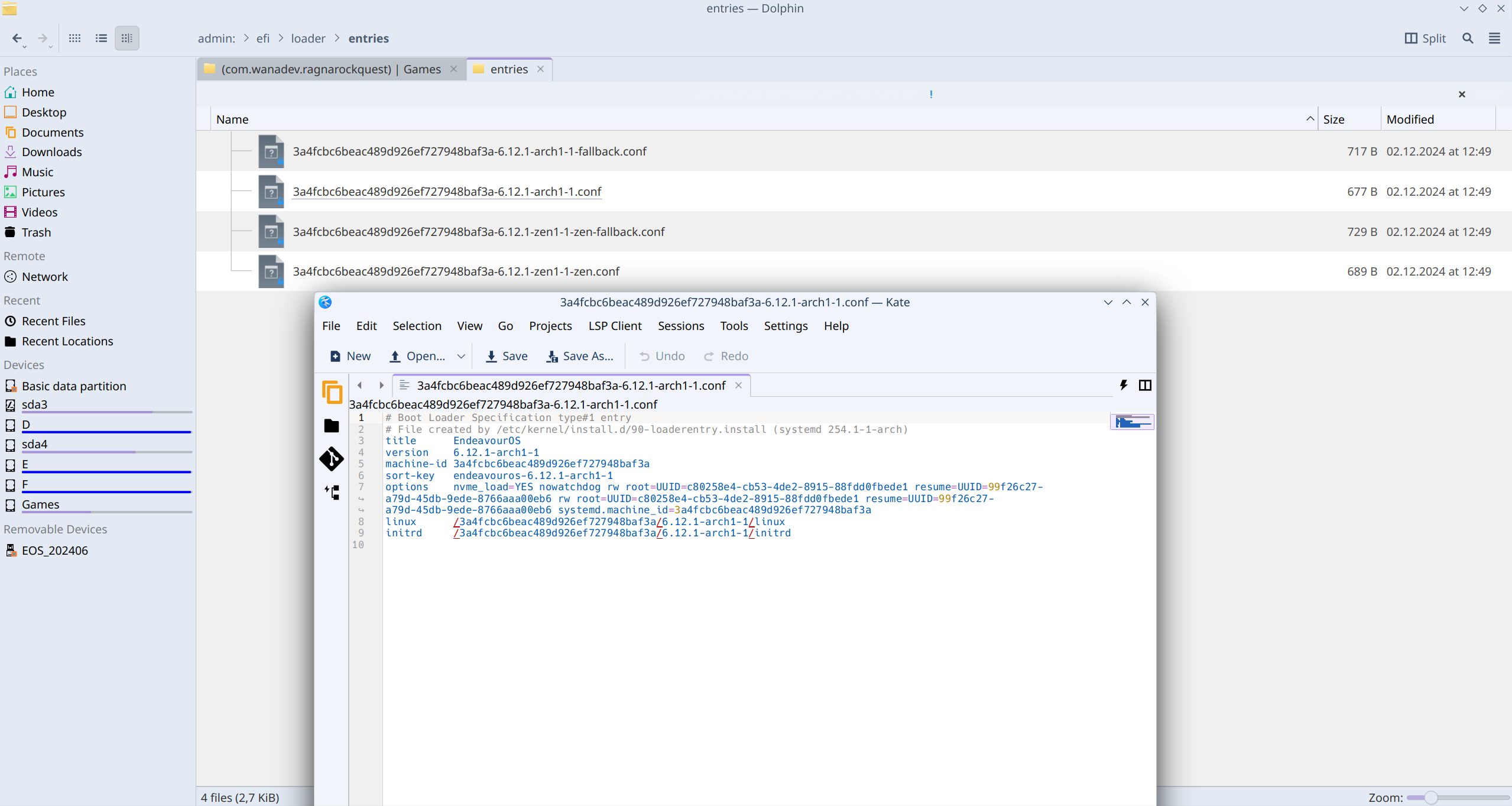

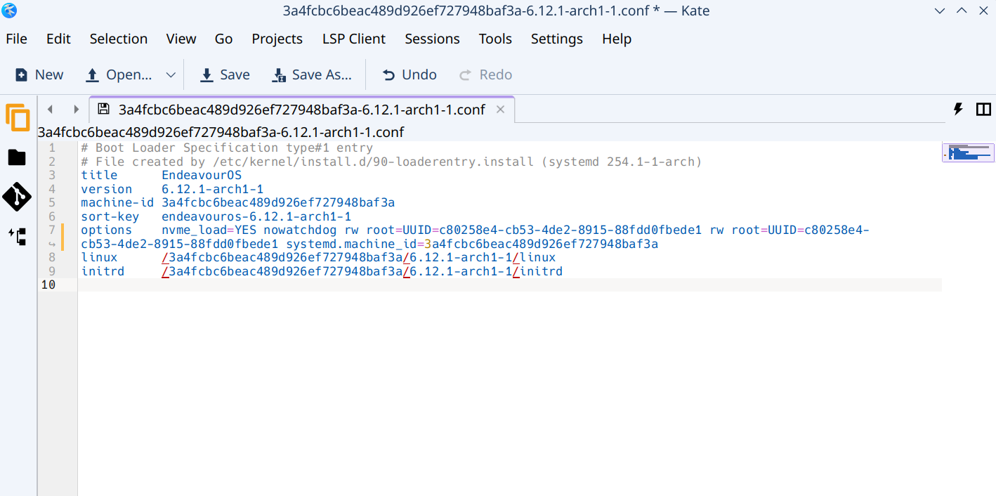

I see, then I assume you mean this file?
And I just do this to it, correct?
Sorry, been having a nap :zzz:
So if it is systemd-boot check /etc/kernel/cmdline the UUID needs changing there, if grub it will be in /etc/default/grub I think…???
