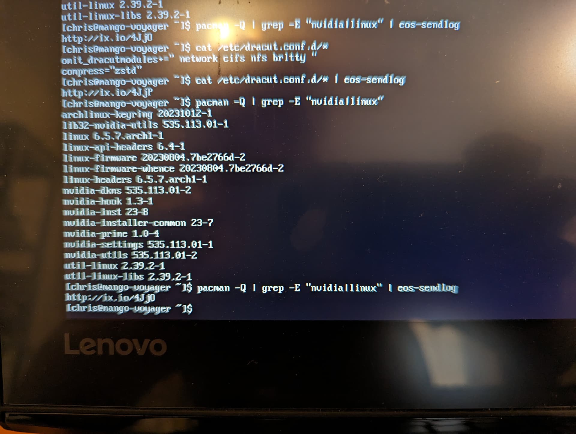

You didn’t share the output for this one.
Hmm something weird going on with eos-sendlog… that middle link is the result of:
pacman -Q | grep -E “nvidia|linux” | eos-sendlog
Heres just a photo of the output
I don’t see anything strange there.
