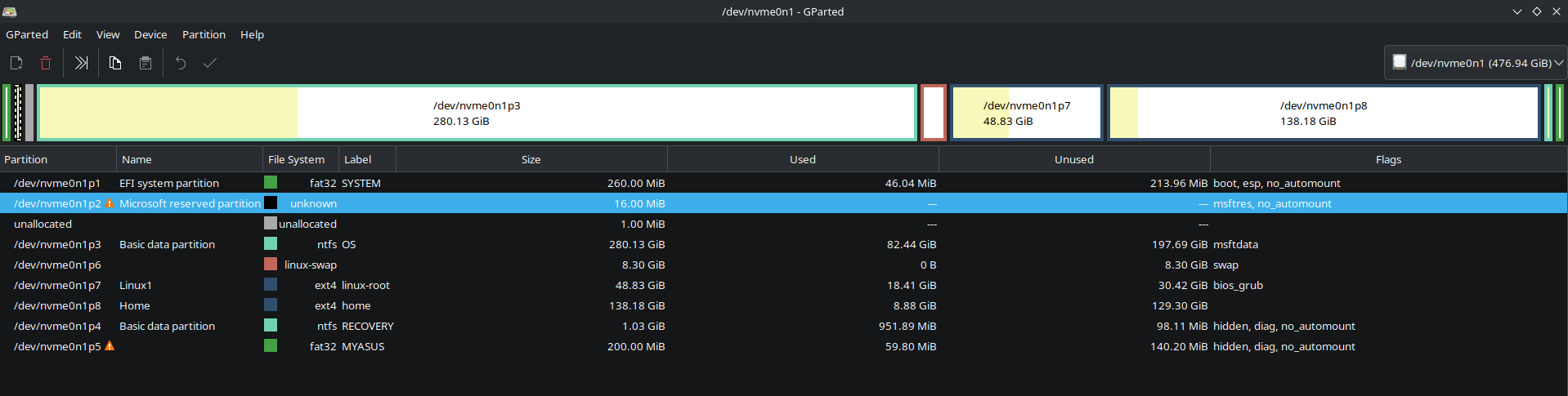

Here a copy og Gparted ; strange the MSR partition ?
MSR is a Microsoft reserved partition. This is meaningless to your problem. It looks like you have a legacy bios install with grub.
You still have to boot on the live ISO and arch-chroot. Then reinstall grub for legacy bios.

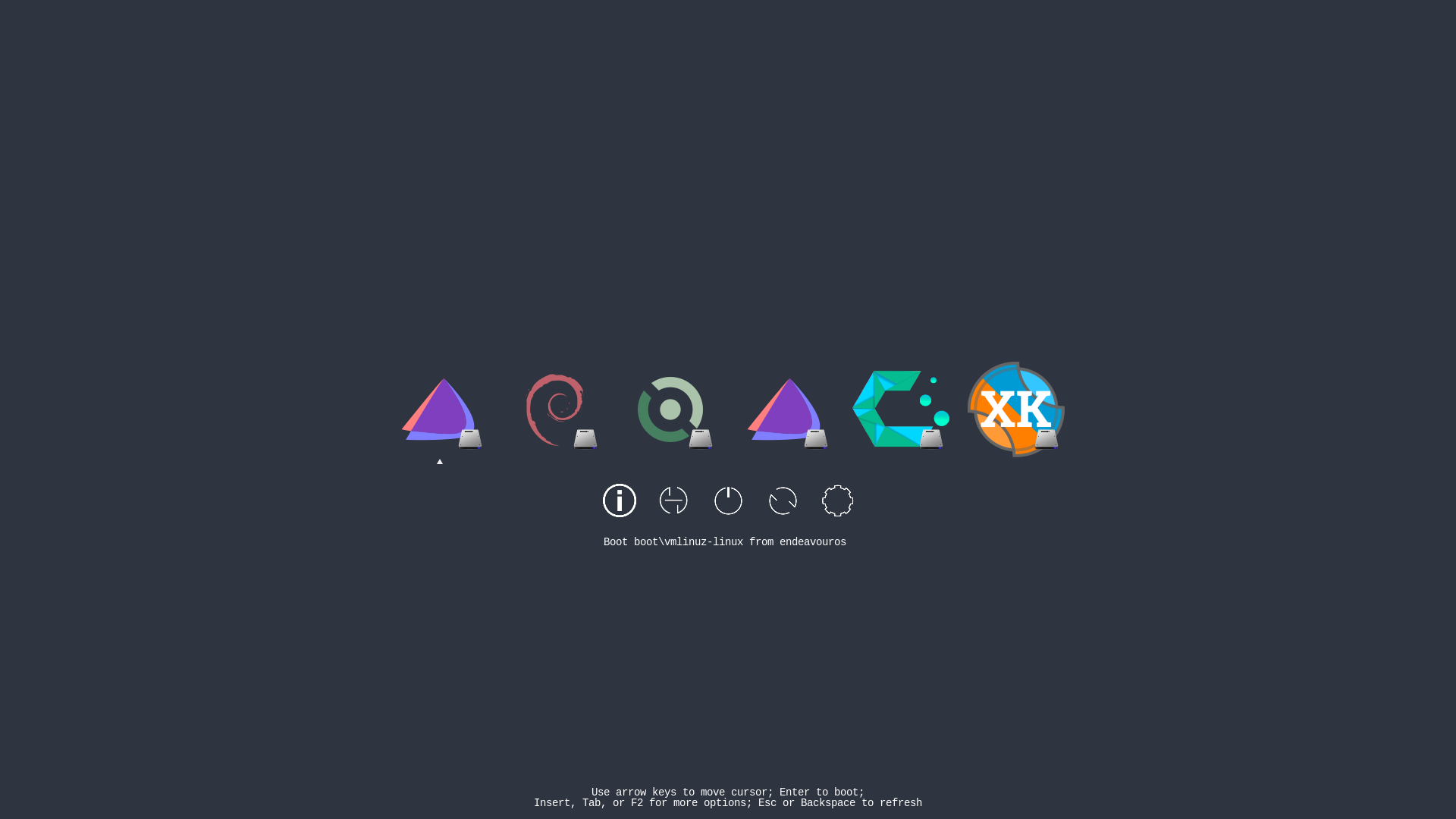

I finally installed refind as ch-root is not working ( folder EFI containt nothing ) ; then now for future OS updating what could happend ? shall I set “ os-prober-disabled = true” in file /etc/default/grub ? I was familiar with grub , it’s the time a such matter occur ( laptop with battery at 0 , it’s my fault )

I’ve become smitten with limine as boot loader, it is human-readable configuration and minimal (unlike cough grub, requiring incomprehensible configuration for customization and arcane invocations of grub-install, grub-update,etc…yeah I am exaggerating a mite..but only a little). Refind (for me) always seemed busy and cluttered, but that’s just an opinion.
If you think this looks busy and cluttered I understand what you mean :grinning_face:
To be fair I used a “inhereted” theme that came from Arco Linux.
