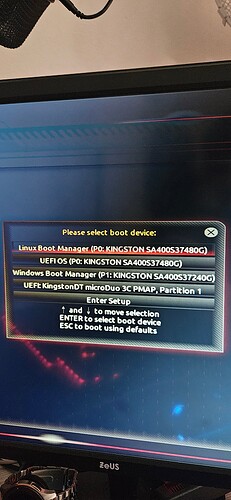

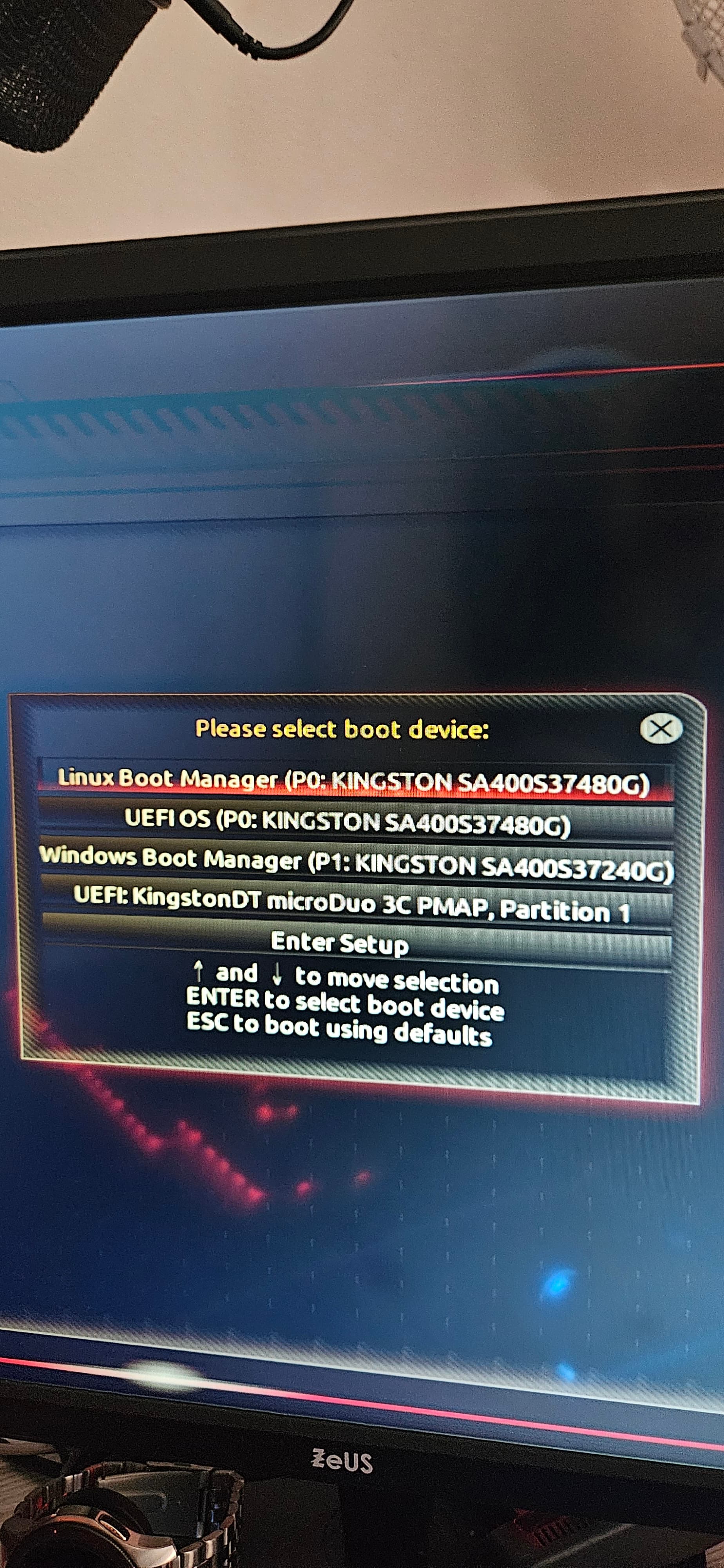

I previously used Fedora and didn’t have this issue. When I installed EndeavourOS, there are now two Linux entries, both leading to the same OS. It’s not two partitions because I formatted the disk where Fedora was. The first two entries are EndeavourOS, the third is Windows, and the fourth is TailsOS. Is it normal for EndeavourOS to have two boot options? (Every OS is on a separate drive. This is my first time using Arch based distro. i tried removing Windows and TailsOS drive but it was still there.)

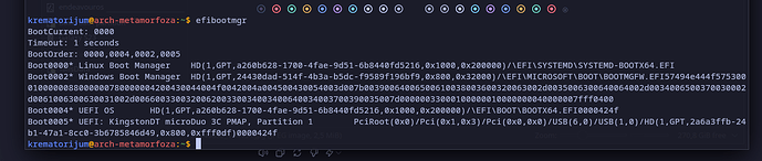

If you want you could post the output of:
efibootmgr
so that we can have a look.

(This may sound dumb but i asked Cloude 3.5 Sonnet about whis and sent him a few pictures and he said it was ok and that i should boot on UEFI OS option.)
It is OK, but you should boot using the Linux Boot Manager option for the reason I described above.
Thank you, that that I always used was Linux Boot Manager but when curiosity got me I wanted to see what would happen when I boot i UEFI OS and i loaded faster.
It is doing the same thing either way. Neither option should be faster.
