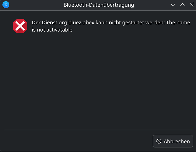

Bluetooth with headset and mouse works fine but cant send/recive files over bluetooth. The error shows

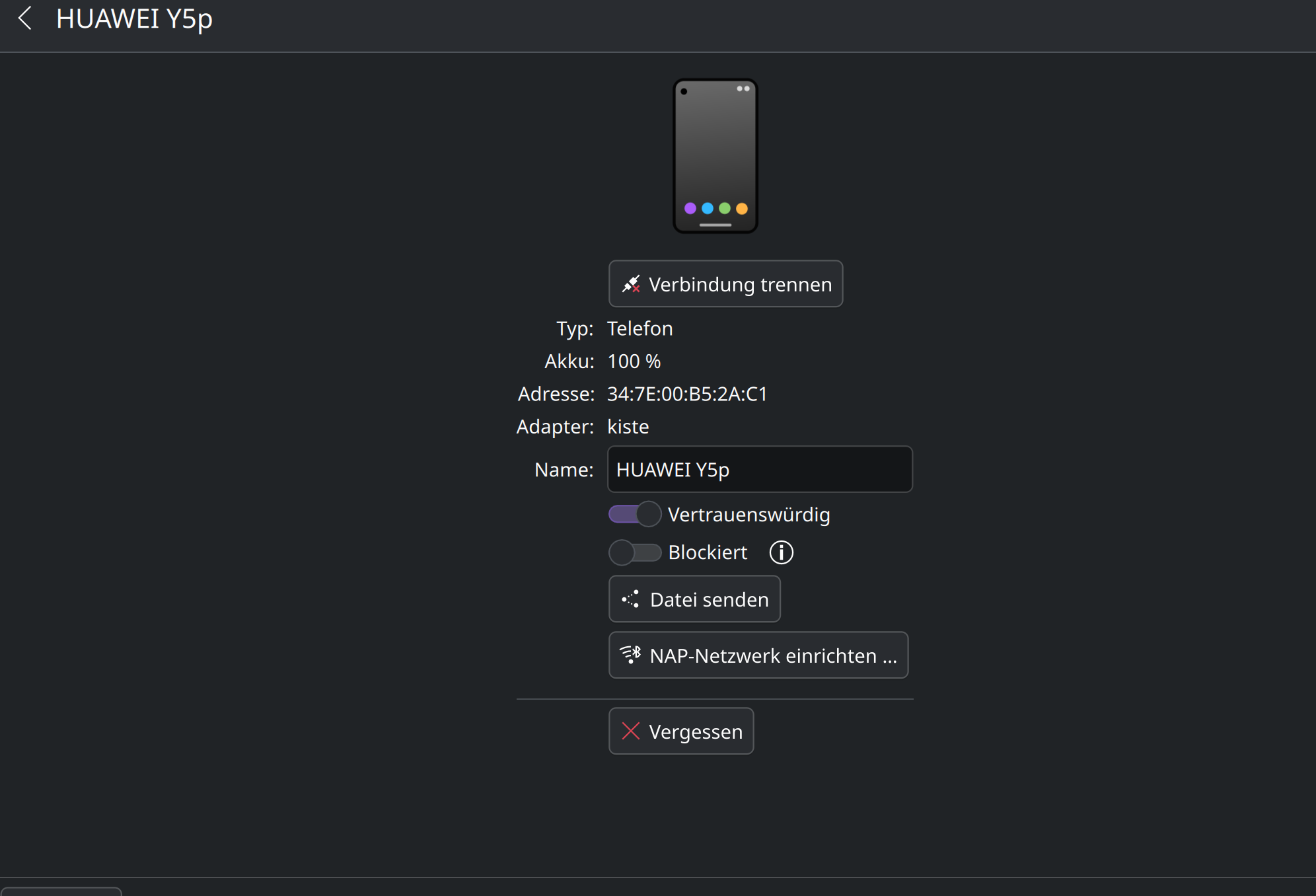

The file should be send from a smartphone to the laptop and the smartphone says it happend, but cant find any incoming file on the hd what was sent from the phone. System is up to date. Here the phone in the bluez section

ah, the obex-error is a KDE-thing, needs bluez-obex installed with pacman. but still no transfer from phone to laptop. step by step.
heeeee hooooo reconecting the phone and now all works fine. so installing bluez-obex with KDE is the soolution
