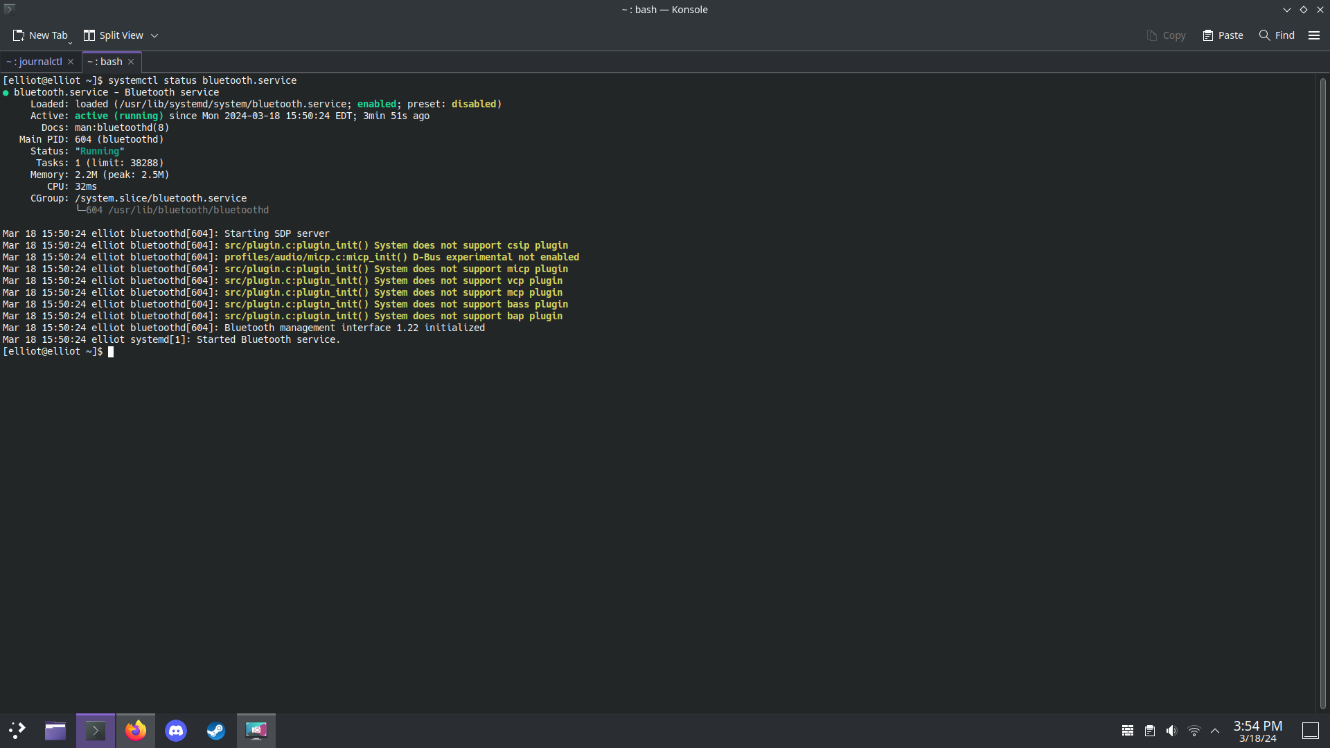

Can you please share the output from systemctl status bluetooth.service?
This will help us better diagnose your problem.
According to all of that, bluetooth should be working.
