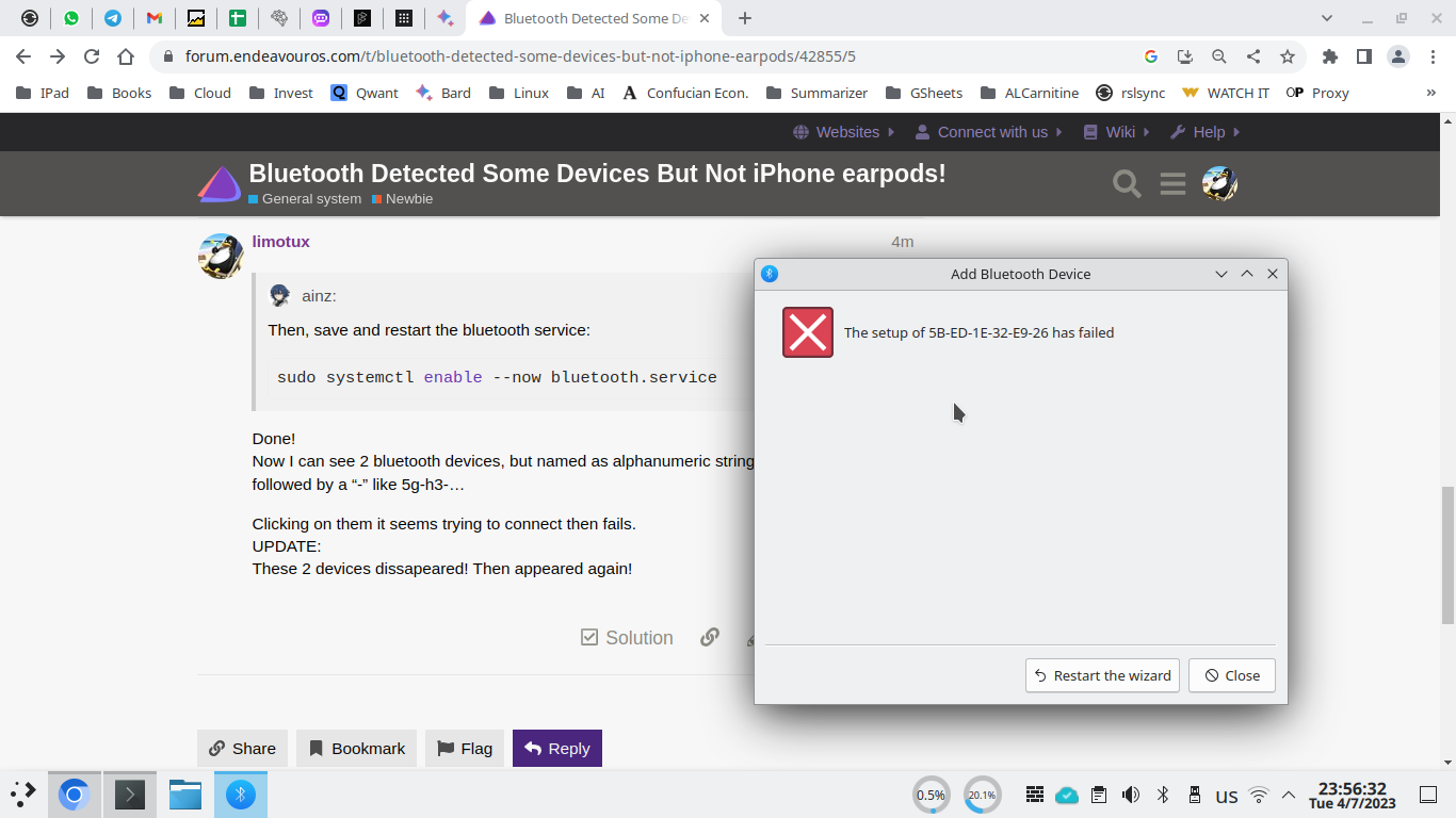

Now I can see 2 bluetooth devices, but named as alphanumeric strings, 2 characters followed by a “-” like 5g-h3-…
Clicking on them it seems trying to connect then fails.
UPDATE:
These 2 devices dissapeared! Then appeared again!
