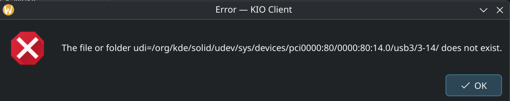

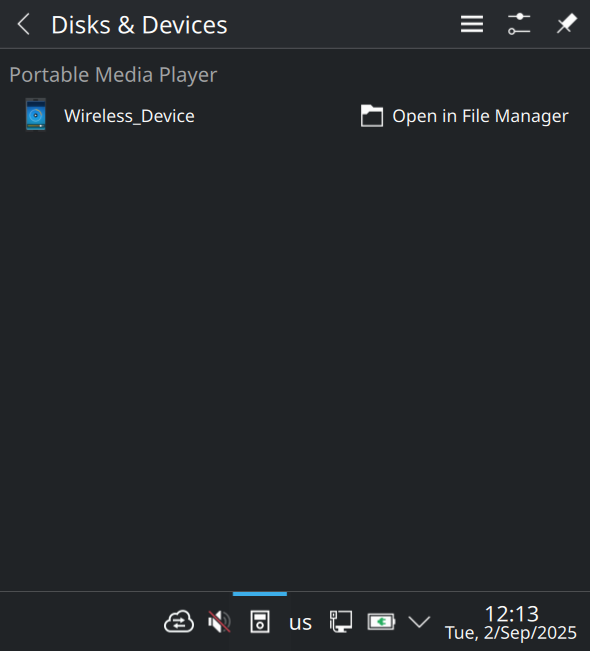

Bluetooth adapter recognized as "Portable Media Player"
My “MediaTek Foxconn / Hon Hai Wireless_Device” is recognized as a “Portable Media Player”.
I recently bought a laptop Legion 5 15IAX10. Everything, including bluetooth, is working fine, except this one small issue. If i click “Open in file manager” it gives the following error: “The file or folder udi=/org/kde/solid/udev/sys/devices/pci0000:80/0000:80:14.0/usb3/3-14/ does not exist.”
Here’s the output of udevadm info about this device.

I couldn’t find any other posts about this or similar issues. Please let me know if you need any other info from me to help me solve this.
Thanks in advance :slight_smile:

Thank you so much for your reply!
i put the following config into /etc/udev/rules.d/99-hide-mediatek-wireless.rules and its finally gone!
SUBSYSTEM=="usb", ENV{ID_VENDOR_ID}=="0489", ENV{ID_MODEL_ID}=="e111", ENV{UDISKS_IGNORE}="1", ENV{ID_MEDIA_PLAYER}="", ENV{ID_MTP_DEVICE}="", ENV{ID_GPHOTO2}="", ENV{ID_INPUT}="", ENV{SOLID_IGNORE}="1", TAG-="uaccess"
SUBSYSTEM=="usb", ATTRS{idVendor}=="0489", ATTRS{idProduct}=="e111", ENV{DEVTYPE}=="usb_interface", ENV{UDISKS_IGNORE}="1", ENV{ID_MEDIA_PLAYER}="", ENV{ID_MTP_DEVICE}="", ENV{ID_GPHOTO2}="", ENV{ID_INPUT}="", ENV{SOLID_IGNORE}="1", TAG-="uaccess"
SUBSYSTEM=="usb", KERNEL=="3-14:*", ENV{UDISKS_IGNORE}="1", ENV{ID_MEDIA_PLAYER}="", ENV{ID_MTP_DEVICE}="", ENV{ID_GPHOTO2}="", ENV{ID_INPUT}="", ENV{SOLID_IGNORE}="1", TAG-="uaccess"
SUBSYSTEM=="usb", KERNELS=="3-14", ENV{UDISKS_IGNORE}="1", ENV{ID_MEDIA_PLAYER}="", ENV{ID_MTP_DEVICE}="", ENV{ID_GPHOTO2}="", ENV{SOLID_IGNORE}="1"
