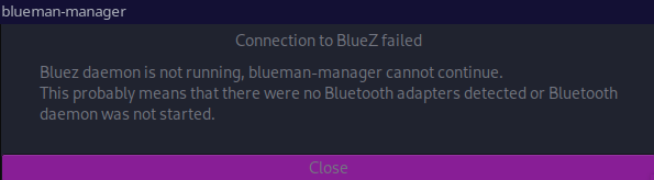

I use Blueman as my GUI and when attempting to start it it just says:

Bluetooth service was skipped because of an unmet condition check (ConditionPathIsDirectory=/sys/class/bluetooth).
Checking dmesg I find nothing about bluetooth at all.
