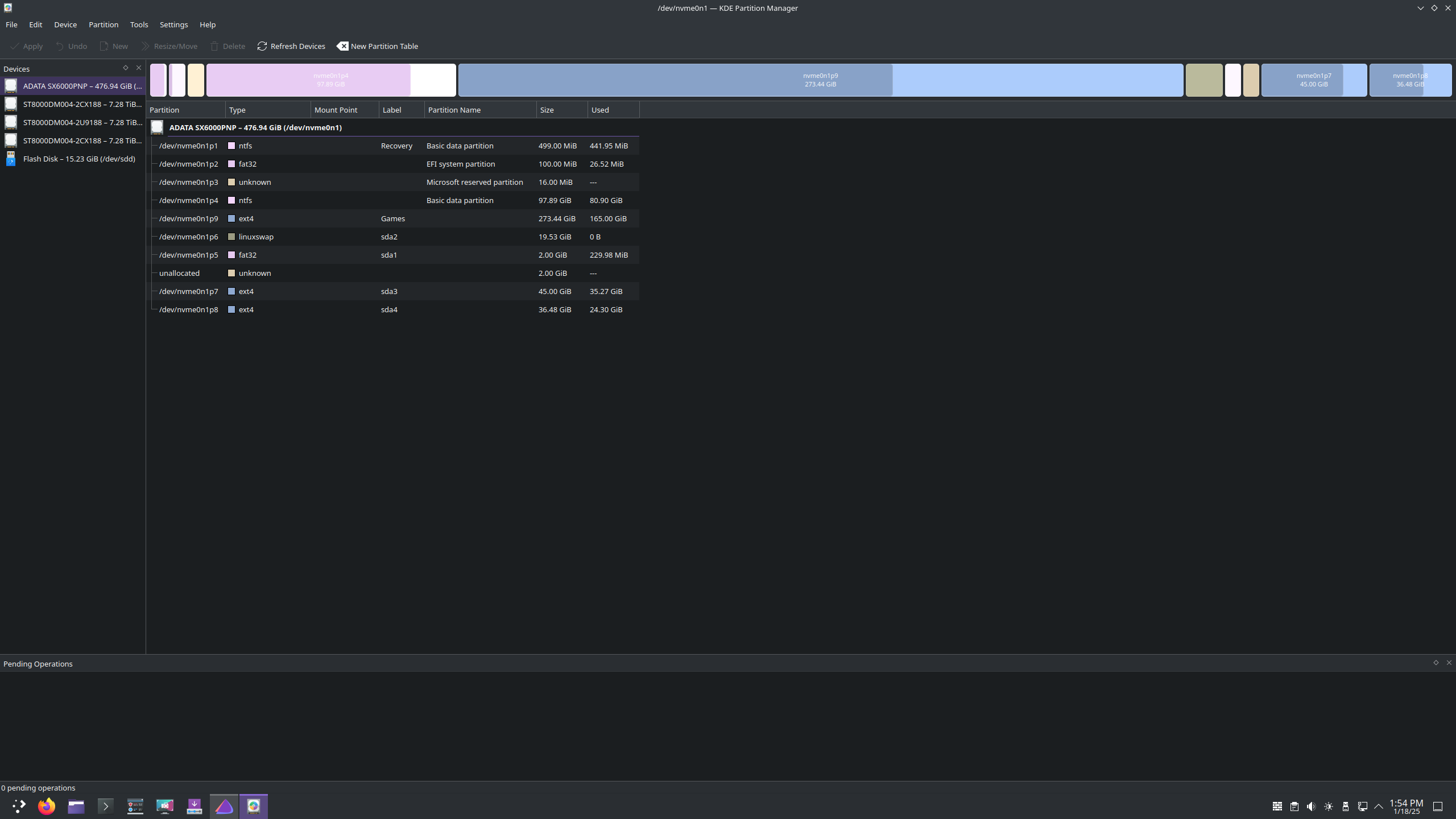

[liveuser@eos-2024.06.25 ~]$ sudo mount /dev/nvme0n1p7 /mnt
[liveuser@eos-2024.06.25 ~]$ sudo mount /dev/nvme0n1p5 /mnt/efi
[liveuser@eos-2024.06.25 ~]$ sudo mount /dev/nvme0n1p8 /mnt/home
[liveuser@eos-2024.06.25 ~]$ sudo arch-chroot /mnt

  4. And lastly yeah, once I hit the black screen with cursor if I do ctrl+alt+f3 I think it was I get a fairly unstable prompt screen that lets me input stuff. And I used it to try all sorts of things I found on the net mostly having to do with reseting the theme and restarting the sddm(if I understand corectly), but none of them worked. Let me know if you want/it matters a list of commands that I tried on it.
Why do I say it’s unstable? Well:
  • whenever I inputed a command that I guess was correct and it was actually trying to run it, it would take quite a long while(over 5 seconds, maybe closer to 10) until it did so and it went to the next line. So not almost instantly like in a terminal for example…
  • at random times it would “refresh the screen”, by that I mean it would erase everything that was on the screen and go back to the original state like it was when I first pressed ctrl+alt+f3
  • whenever I tried a command that required sudo I would enter my password 100% correctly, just like I’ve done a million times before, and it always told me it was not correct…
P.S. Not sure how relevant this is, but might as well mention 2 more changes that I noticed happened after a certain point just so you have all the info:
  1. At first after the boot up sequence(the part where things scroll on the screen and everything hopefully shows green OK’s) I would just get a black screen with a black cursor with white outlines and that would be that.
    Now I get that screen for a split second, then the cursor disappears and the screen goes to a blacker black then usual(almost like the monitor is not recieving a signal anymore) then after a second or two of that it goes back to the regular black and a _ will appear in the upper left corner for a split second, then it goes away and the mouse cursor comes back and stays like that.
  2. Even booting into the live usb(don’t ask me how the heck this could even get affected…) now after the last screen, the one with
    “Welcome to your endeavor
    version…”
    I get a black screen with a fully white mouse cursor this time and it hangs on this screen for a good 20 seconds or so, then a little rectangular message window pops up in the middle of the screen for a fraction of a second(way too fast for me to figure out what it is) and then the desktop finally loads.
Obviously it didn’t used to do this before and after the “Welcome to your endeavor” screen it would go into the desktop almost immediately… :confused:
So there you have it, thoughts? :thinking:
With the issues your describing it is possible its a memory module or hard disk issue.(physical) The erratic behavior even on the Live disk suggest a hardware issue. I would check the drive and the memory sticks.
does this erratic behavior happen in the Live environment no matter what USB you plug in to?
