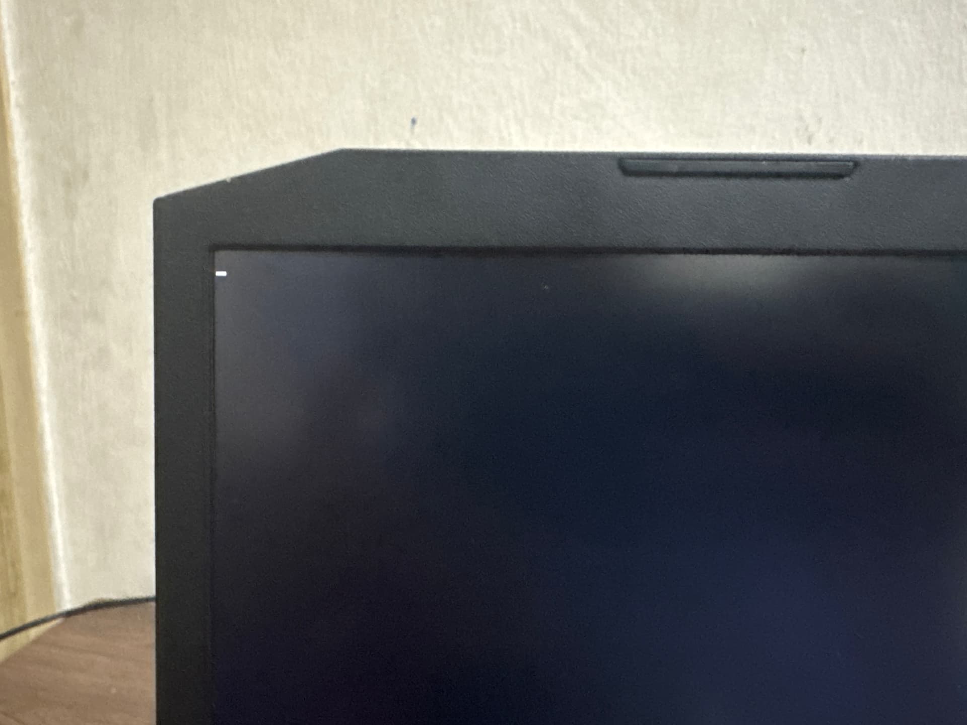

Black Screen with a single non-flash underscore after Fresh Install
I’ve decided to install Endeavor OS today for the first time but after carefully installing right as it restart and tries to boot to the OS it just stuck on this (picture I attached). Need help as I’m still new to this

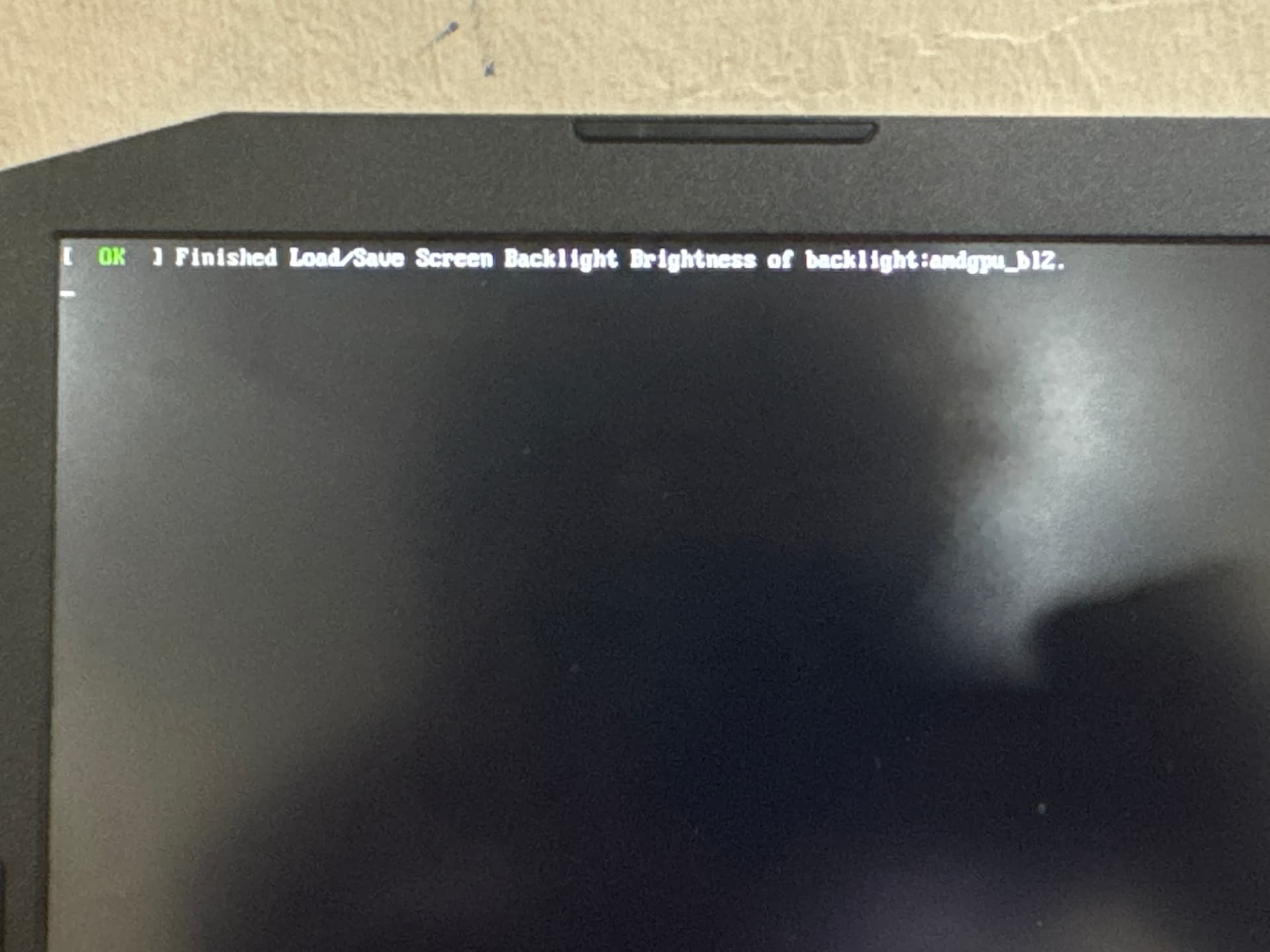

I’ve done the chroot and the install nvidia-inst but now its stuck at this
alright finally got it working, might have typed something wrong or something. Thanks!
