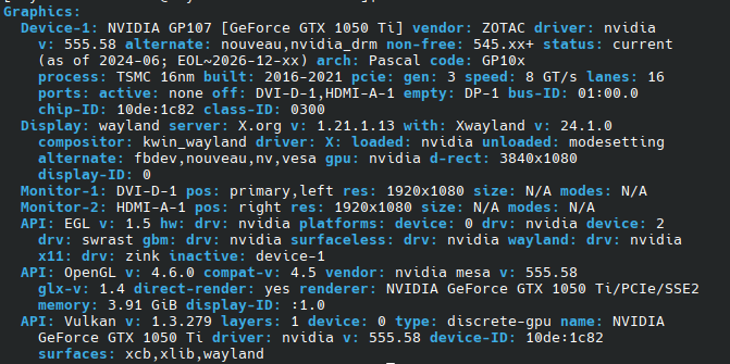

I just updated my Nvidia 15050ti drivers from 550 to 555 and was exited because of fixes and all. My 550 was working fine from out of the box installed by nvidia-inst. Now after updating to Nvidia 555 with the same command, and then restating, my one monitor not working and showing black screen. SO I messed with many many commands and combinations to make it work. But failed to do so. So I decided to reinstall the OS and did it. But after updating system and installing nvidia 555, my one monitor not working. Only one monitor working out of two. I have dual monitor setup.
I think there is problem with Nvidia 555 stable on wayland.
I am running latest and updated KDE on Wayland
I have Nvidia 1050Ti GPU
I reinstalled EOS to fresh one
I am on Systemd
nvidia-dkms is also there

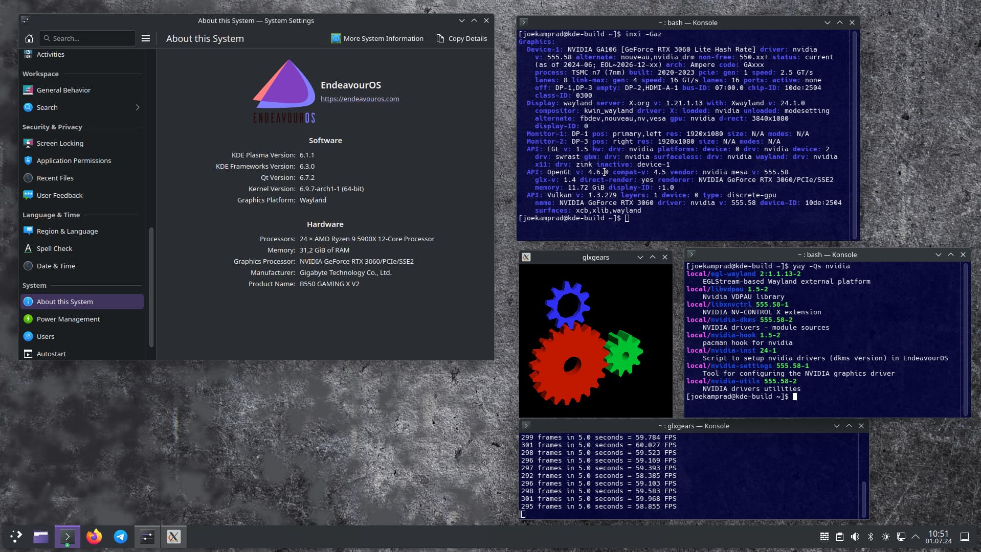

i can confirm also zero issues with the Nvidia update running on a 3060 using nvidia-dkms Plasma on Wayland:

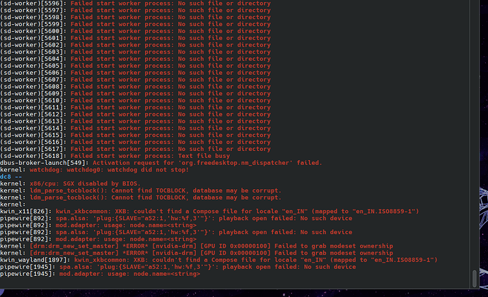

The problem is with my dual monitor. One is working and another is not. Working fine with x11. But when I login with Wayland, its only one monitor.
Tried every possible method. I have had this probem on manjaro and ESO also but after following the archwiki instructions, the problem solved. But after this 555 update, it come back.
