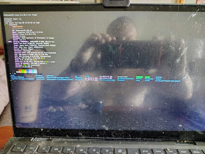

Black screen after I start up my computer. I can get to TTY :-(
Idk what I did but I can only get to TTY now. I’m totally confused as how to fix this I am so sorry this happened. I got stuff on my computer that I need to do idk any help would be very, very, appreciated. I was trying to install cosmic desktop enviroment, i3, sway, and hyperland on my computer right before this happened. I honestly didn’t know what I was doing though and I think I screwed everything up. I don’t even remember exactly what I did so that’s a big problem too. I am so sorry but yeah if anyone could help me I would really, really appreciate it because I need my stuff off my computer. I know there’s a way of finding errors and stuff on Linux but I don’t know how to do it. If I could find the errors maybe you could point me to some kind of solution. Thanks again to the endeavors community. This totally sucks me honest but hopefully someone can help me figure it out.

Yup once I get to TTY I enter systemctl start sddm and I can get into my computer but it still loads to a black screen initially
