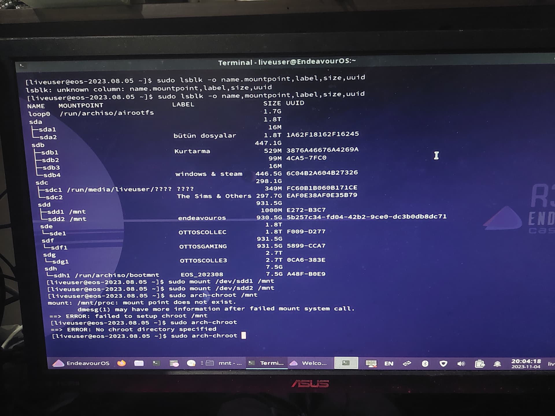

UPDATE: I can’t use mounted partition with arch-chroot, and I also can’t find the reason of this error.
Looks like you mount sdd1 and sdd2 to the same mount point /mnt
It is enough to mount only one of them, which has actual system. Or if you want both of them, mount to other mount point, example /mnt/efi

I just only mounted ssd2, gave the same error.
