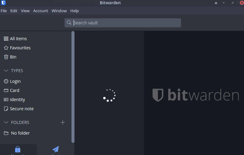

Starting today I cannot Sync, edit or add items in the app.
Version 2024.4.0
Shell 28.3.0
Renderer 120.0.6099.291
Node 18.18.2
Architecture x64

Sync failed_Bitwarden 1
Looks like “Failed to decode access token: JWT must have 3 parts” is from the latest update

Just did. and lost what I have cached… Now is endless loading since couldn’t sync.
No, it did help. No sync.

did all that in the order you suggested. After re-installing still no sync :frowning:
Interesting how Bitwarden detects that I have logged using the app
But still cant sync
