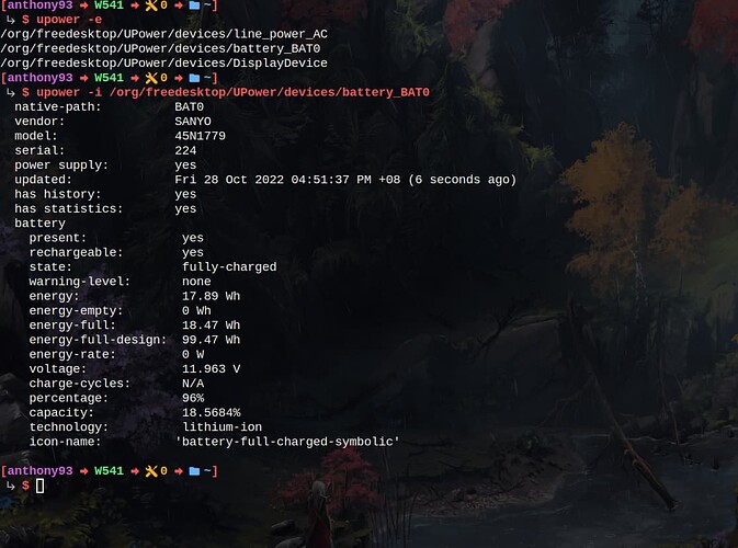

But… just to give you how bad of a state my current battery is in…
This is an 8-year-old ThinkPad.
I’ve never depleted the battery completely, but I know it dropped to below 10% a few times. I was in engineering, so I used the machine doing a lot of CAD work (that was before I switched to Linux, of course)
if the battery is that old you really cant do a lot for it, The batteries can only last so long and no amount of babying is going to save an 8yr old battery from losing max charge lol

I’m aware. I just wanted to know more before I decide to get a replacement battery.
