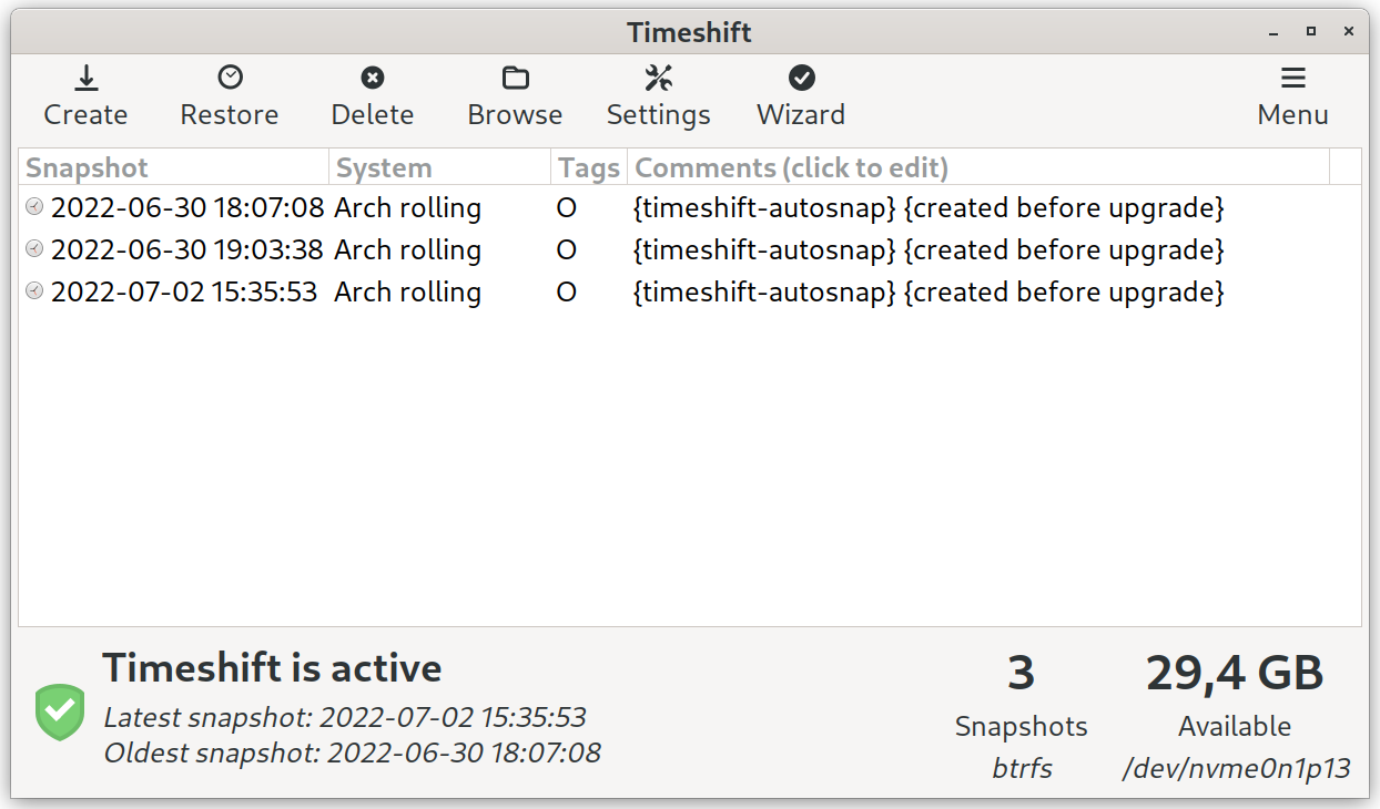

BACKUP: my 3 pillars are timeshift + rsync, and optionally btrfs.
I’ve customized the very same scripts to run on several machines, EFI or legacy bios, Intel or Amd, ext4 or btrfs.
I use dedicated physical disks for my rsyncs, plus a second unit for timeshifts in ext4 mode.

— About btrfs & timeshift —
Convert to btrfs:
FEDORA guide: https://fedoramagazine.org/convert-your-filesystem-to-btrfs
TitusTech guide: https://christitus.com/btrfs-guide/
( Youtube BTRFS Guide | The Best Desktop File System - YouTube )
Also on Youtube, Stephen’s Tech Talks:
“Speedy Install EndeavourOS 2021.04.17 ArchLinux with BTRFS, TimeShift, Gnome 40, ZRAM, and PipeWire”
But above all, see “Timeshift and grub-btrfs in Linux Arch” by Lorenzo Bettini ( it’s in English )
More:
How To: GRUB-BTRFS Snapshot Booting on Arch Linux Systems

You are not in a mess. It is easily fixable and there are several threads on the forum on how to fix it. Snapshots on BTRFS may have made it easier depending on how you set up the snapshots. Long answer maybe short answer nope.
Thank you Piero for your help and scripts. They will be useful later when I have reinstalled and have btrfs set up :+1:
P.S.: running # timeshift --restore from a live usb terminal after arch-chrooting has perfectly fixed all my ext4 installations.
Guess/wish it can do as well on btrfs machines, good luck folks.

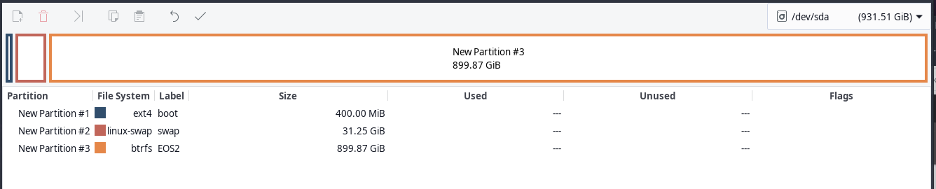

I’m getting ready to install.
Launched Gparted and this is what I have set up - seeking advice from more experienced folks before I carry on :+1:
Previously disk space was nearly 50/50 Pop OS and EndeavourOS. But this time around I want to give it the full amount, minus swap and boot partition.

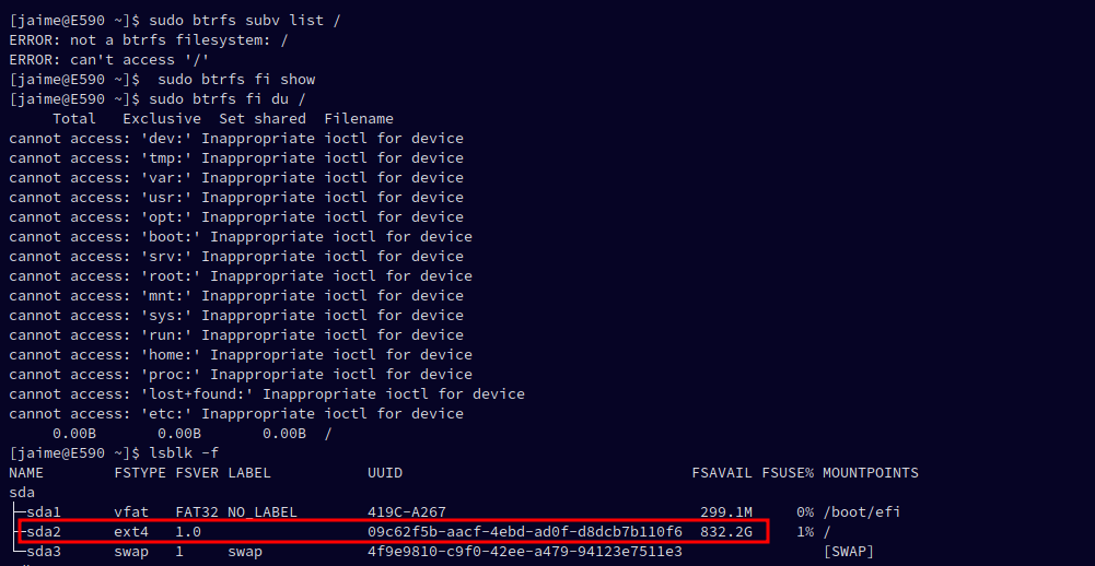

Now I’m off to learn about brtfs and timeshift before I install anything :wink:
hhmm, I know I selected btrfs while setting up the installer, but it didn’t work!
Should I go through the installer again?

I mean, if you wanted btrfs, you will have to, yes.
I like ext4. It’s been a long running staple.
