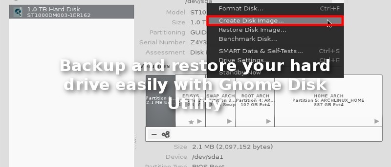

this is actually the tutorial i was reading, it was the one that called this method foolproof, i am the fool it is hopefully proofing for enough!
You could use Clonezilla and clone all of your disk, including partitions and whatever is on there.
alrighty, i got my .img file, now just to make 100% and put my smooth brain to rest.
if i have to reinstall endeavouros again for one reason or another.
i use a liveusb with it, install gnome disk utilities, restore the image.
and by the end of it i have the drive back exactly how it was by the time the .img was created?
I guess the purpose of having a backup image of the system is to eliminate the need of re-installation. If you feel your system is somewhat “messed-up”, you could always restore an image of it from when it was in good working condition using a live usb.
can i take this as a yes?
Yes. And I would also suggest to make a backup of your partition table. If you by any chance need to wipe the drive, you could re-create it as it was partitioned before and then restore the .img file.
