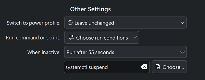

Oh, alright, I see. May I propose another workaround then.
You were saying that invoking systemctl suspend works fine, so in the Power Management settings in the Other Settings section, select run condition “When inactive” and enter systemctl suspend command with a a different timeout, say something like 55 seconds
It might work. Good luck.
That does work as a workaround! Thank you very much.
Well, unfortunately, the Other Settings, when inactive does not take into account if a video or other source is blocking sleep and will only execute based on time since last input. Meaning it will sleep while watching a video. So not quite a solution but thanks for the help regardless.
Ah, KDE, always missing the details.
It’s not a big deal, we can create a small script that will check if there are any inhibitions before suspending
The one-liner for you :laughing:
#!/bin/bash
[ "$(busctl --user call org.kde.Solid.PowerManagement.PolicyAgent /org/kde/Solid/PowerManagement/PolicyAgent org.kde.Solid.PowerManagement.PolicyAgent HasInhibition u 1 | awk '{ print $2 }')" = "false" ] && systemctl suspend
Save it to a file, make the file executable, and use it instead of systemctl suspend command.
Disclaimer, have not tested this thoroughly, you may need to adjust it to your needs.
Based one liner thank you. Marking as solved! Thank you!!!:star_struck:
