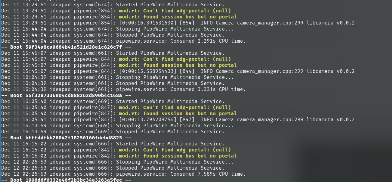

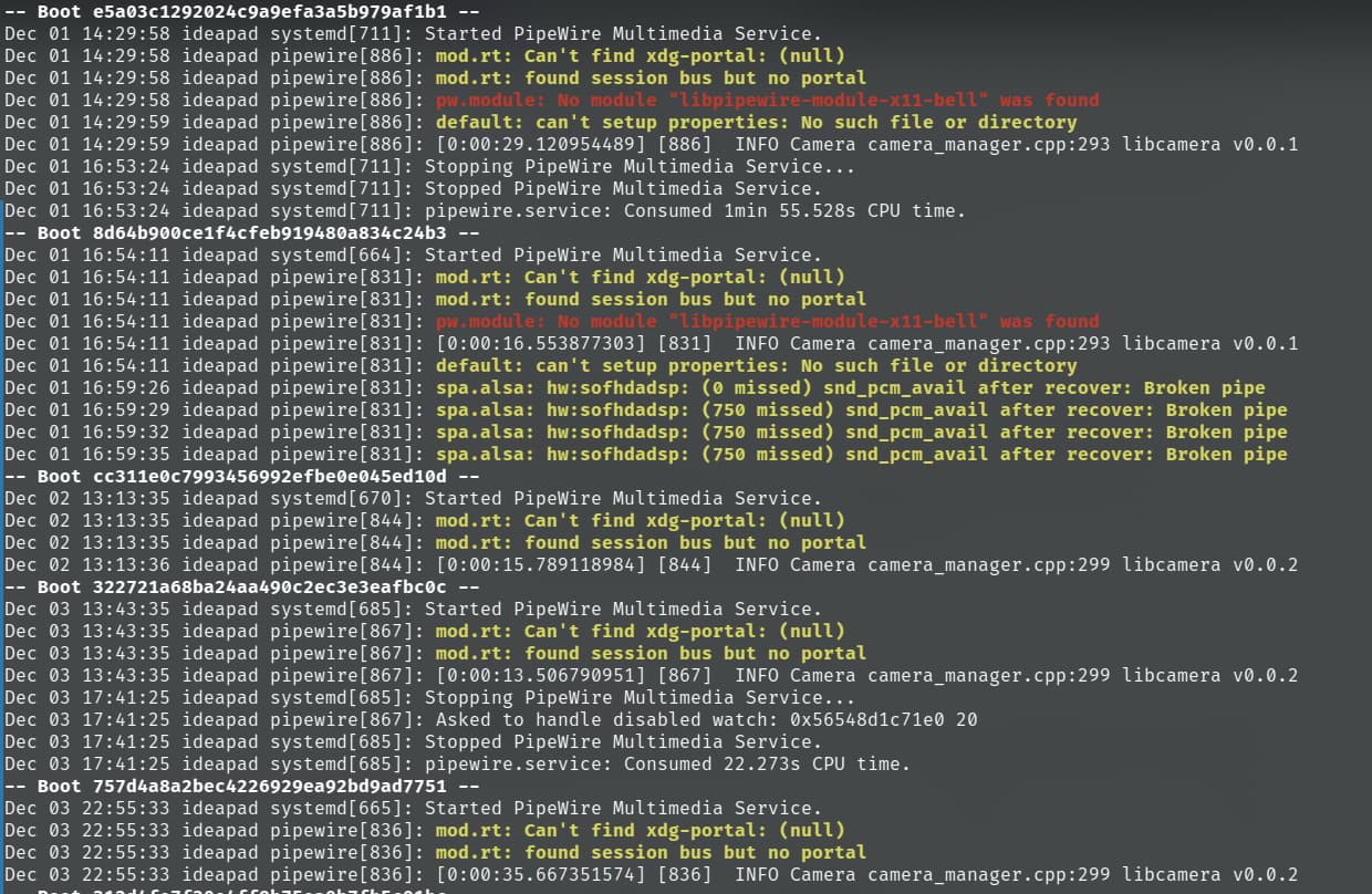

This is what I got for today:
The previous logs were all similar to this up until around Dec. 1, which looked like this:

[2022-12-11T16:13:13-0500] [PACMAN] Running 'pacman -Syu'
[2022-12-11T16:13:13-0500] [PACMAN] synchronizing package lists
[2022-12-11T16:13:18-0500] [PACMAN] starting full system upgrade
[2022-12-11T16:13:43-0500] [PACMAN] Running 'pacman -S pipewire-media-session'
[2022-12-11T16:13:47-0500] [ALPM] transaction started
[2022-12-11T16:13:47-0500] [ALPM-SCRIPTLET] Removed "/etc/systemd/user/pipewire-session-manager.service".
[2022-12-11T16:13:47-0500] [ALPM-SCRIPTLET] Removed "/etc/systemd/user/pipewire.service.wants/wireplumber.service".
[2022-12-11T16:13:47-0500] [ALPM] removed wireplumber (0.4.12-2)
[2022-12-11T16:13:47-0500] [ALPM] installed pipewire-media-session (1:0.4.1-2)
[2022-12-11T16:13:47-0500] [ALPM-SCRIPTLET] Created symlink /etc/systemd/user/pipewire-session-manager.service → /usr/lib/systemd/user/pipewire-media-session.service.
[2022-12-11T16:13:47-0500] [ALPM-SCRIPTLET] Created symlink /etc/systemd/user/pipewire.service.wants/pipewire-media-session.service → /usr/lib/systemd/user/pipewire-media-session.service.
[2022-12-11T16:13:47-0500] [ALPM] transaction completed
[2022-12-11T16:13:47-0500] [ALPM] running '30-systemd-update.hook'...

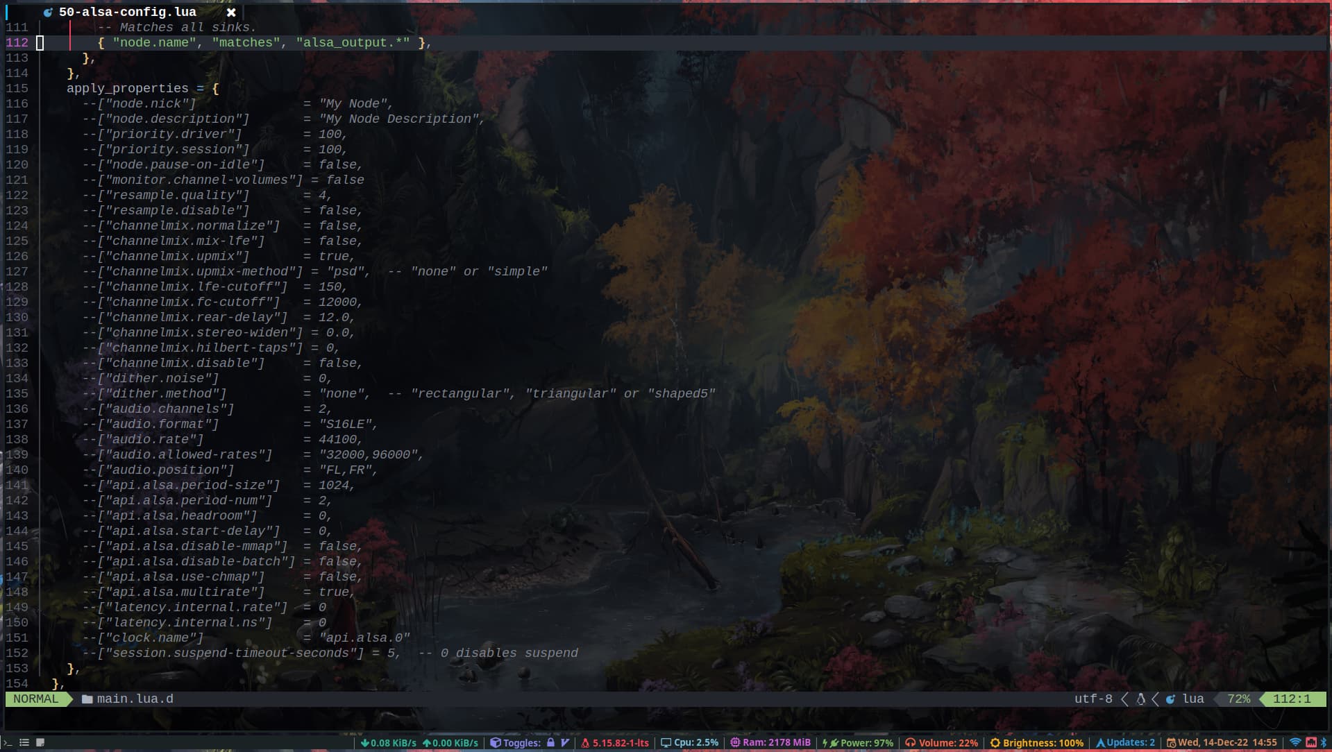

You said the audio only starts to give problems when you stop playing audio for a while but not when the audio is playing continuously?
I’m beginning to suspect that this might have to do with Wireplumber’s “suspend on idle” setting.
Can you cd
into /usr/share/wireplumber/main.lua.d/
and open a file called 50-alsa-config.lua
? Scroll down to the bottom to the apply_properties
section. You should see a bunch of commented out lines like this:
Uncomment this line:
--["session.suspend-timeout-seconds"] = 5,
And change the timeout-seconds to 0 to disable suspend. After that, reboot and see if the problem still occurs
Could it be related to that? => After update, pipewire needs to be restarted often
I had problems where my audio suddenly stopped working and Discord was the cause of this. Audio usually worked fine but when I had Discord running and didn’t play audio for a while all audio was broken.
I fixed it by setting ["api.alsa.headroom"] = 512
(Here is a guide on how/where to set this property => https://gitlab.freedesktop.org/pipewire/pipewire/-/wikis/Troubleshooting#underrununderflow-and-broken-pipe-errors )
