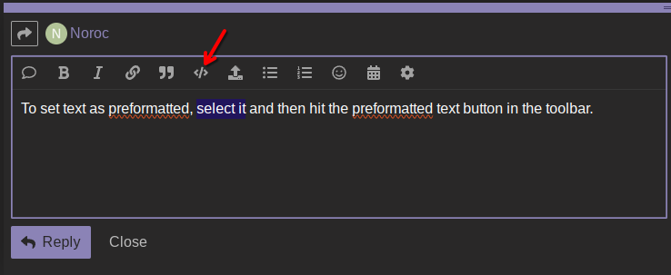

Perhaps share some of these (paste the output in as pre-formatted text, not screenshots please).

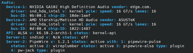

Audio hardware details:
inxi -Axx

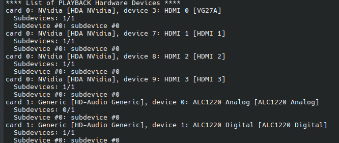

Playback devices:
aplay -l

Audio:
  Device-1: NVIDIA GA102 High Definition Audio vendor: eVga.com.
    driver: snd_hda_intel v: kernel pcie: speed: 5 GT/s lanes: 16
    bus-ID: 0b:00.1 chip-ID: 10de:1aef
  Device-2: AMD Starship/Matisse HD Audio vendor: ASUSTeK
    driver: snd_hda_intel v: kernel pcie: speed: 16 GT/s lanes: 16
    bus-ID: 0d:00.4 chip-ID: 1022:1487
  API: ALSA v: k6.10.2-arch1-1 status: kernel-api
  Server-1: sndiod v: N/A status: off
  Server-2: PipeWire v: 1.2.1 status: active with: 1: pipewire-pulse
    4: pw-jack type: plugin

**** List of PLAYBACK Hardware Devices ****
card 0: NVidia [HDA NVidia], device 3: HDMI 0 [VG27A]
  Subdevices: 1/1
  Subdevice #0: subdevice #0
card 0: NVidia [HDA NVidia], device 7: HDMI 1 [HDMI 1]
  Subdevices: 1/1
card 0: NVidia [HDA NVidia], device 8: HDMI 2 [HDMI 2]
  Subdevices: 1/1
card 0: NVidia [HDA NVidia], device 9: HDMI 3 [HDMI 3]
  Subdevices: 1/1
card 1: Generic [HD-Audio Generic], device 0: ALC1220 Analog [ALC1220 Analog]
  Subdevices: 1/1
card 1: Generic [HD-Audio Generic], device 1: ALC1220 Digital [ALC1220 Digital]
  Subdevices: 1/1

Thank you, I was over thinking the pre-formatting thing…

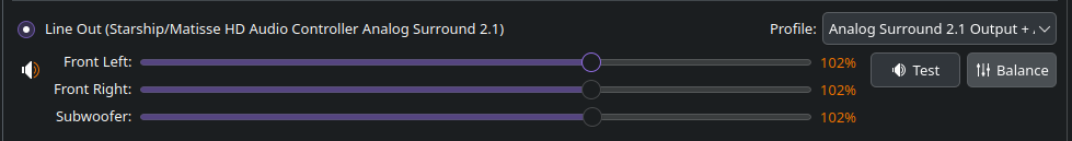

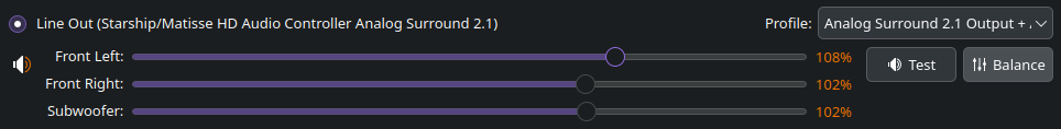

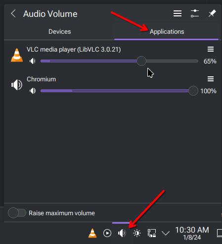

Nope those commands did not work, here is some screenshots that maybe explain it better.
I don’t issue with Bluetooth audio like the earlier post, I have a issue with wired audio.
If the volume is set even from 0 - 150%, I barley hear anything from a youtube video.
If the volume is set uneven, I can hear the people speaking in a youtube video.
but its not really a solution, more of a work around as sounds are not even.
Just in case it’s something simple, have you checked your per-application volume, to make sure that’s not offsetting your general volume?
Now based on your screenshot, can I assume you’re using speakers? Are you able to test your sound with a pair of wired headphones? It’d be good to see if this may be line-out/surround related, by testing with headphone/stereo.

I tried messing with applications, I don’t think that did anything.

The output and profile you’ve selected would seem to be appropriate for speakers though, so I wonder that might need adjusting.
Ideally, they should be getting picked up as headphones, not line-out (for correct amplification), and I would also try testing with stereo output, not surround 2.1 (even if the headphones claim to be “surround”).
To achieve true “surround” on headphones, you’ll need a digital connection. An analogue stereo jack isn’t going to accomplish that.
