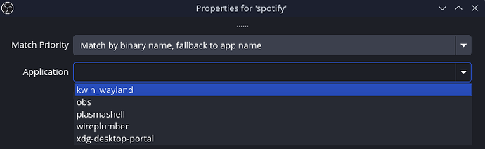

  4. the use of this obs plugin for program audio capture via pipewire no longer detects programs, for example spotify can be open and playing audio but wont appear in the list. However microphone input with pipewire works. However desktop capture with pipewire doesnt work?
    No audio being picked up other than the microphone.
