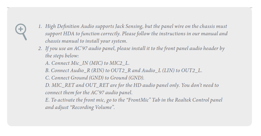

Edit: Have you checked the front audio header to make sure you have the wires connected properly?
Edit:
Edit: Check UEFI Bios settings for audio.

I have tried to confirm and it is impossible for me to plug in the front panel audio header incorrectly. The pinout is designed in such a way as to not allow this.
I am fairly certain that my case is using HDA and not AC’97, as the header is labeled AUDIO rather than AC’97 which while not definitive does point in the direction of it being HD Audio. The case is also fairly recent, so I can’t imagine why or really even how they would’ve gone with an audio codec from 1997. As well, the header being AC’97 would not explain why even the motherboard’s own onboard lineout has ceased functioning, even with the header unplugged.
In the UEFI BIOS, I have tried the following configurations:
Onboard HD Audio Auto, Front Panel HD
Onboard HD Audio Enabled, Front Panel HD
Onboard HD Audio Auto, Front Panel AC’97
Onboard HD Audio Enabled, Front Panel AC’97
