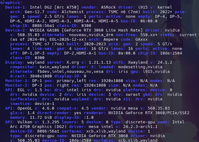

Just installed testing versions and it seems to resolve all the issues … all displays properly detected performance is back to normal on wayland:
Bildschirmfoto_20241004_222000
but you set the boot options for drm modesetting and fbdev?
Yes i still have it set even with the updated nvidia drivers. I could remove it and check also.
Edit: I just removed the kernel parameter and updated grub. It still boots and loads on the lts kernel with nvidia no problem.
