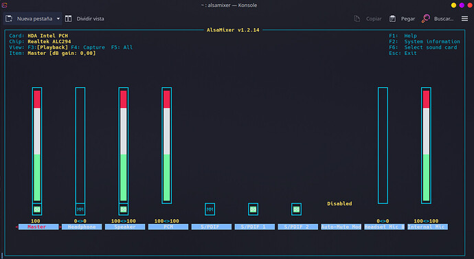

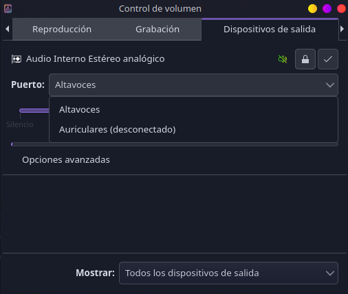

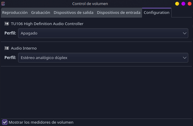

I’ve spent 3 hours now trying multiple things bu nothing works. The speakers are recogniced by EOS and if I play audio the little bar on the bottom of the pavucontrol audio output shows that’s playing but still no sound.
If I connect the headphones using jack or I use an HDMI monitor I can change the output and it works fine on both but after disconnecting both and changing(manually and automatically after disconnecting) the same problem shows up.
The speakers works fine as the startup sound of my BIOS works fine and they were working on Windows.
I’ve Fast Bood disabled.
I’ve made sure sof-firmware and alsa(multiple packages) are installed and working.
I’ve made sure pipewire is installed and working.

[xurxomf@xurxo-asusrogstrixg15 ~]$ pactl list short sinks
589     alsa_output.pci-0000_00_1f.3.analog-stereo      PipeWire        s32le 2ch 48000Hz       SUSPENDED

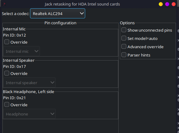

[xurxomf@xurxo-asusrogstrixg15 ~]$ sudo cat /etc/modprobe.d/alsa-base.conf
options snd-hda-intel model=alc294-lenovo-mic

After some testing I’ve found that the /etc/modprobe.d/alsa-default.conf → option snd-hda-intel model=alc294-lenovo-mic is not applying as the /sys/module/snd_hda_intel/parameters/model is still asus-mic,(null),(null),(null),…
I’ve tried adding this rule on the /etc/default/grub → GRUB_CMDLINE_LINUX_DEFAULT= but it doesn’t work neither…
I don’t know what else to try…some users got it working with this steps but I’m not able to.

Have you tried
'options snd-hda-intel model=asus-zenbook'
I did. The thing is that after restarting the /sys/module/snd_hda_intel/parameters/model is still asus-mic… I don’t know if this is correct or if this varue should change to asus-zenbook.
