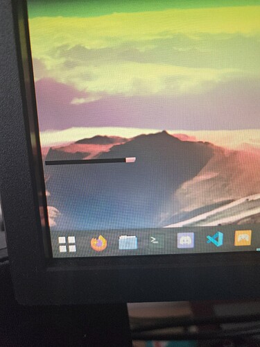

I have an unusual problem. Every now and then graphic blocks pop up on my desktop obscuring elements of the application interface. Computer mouse movements help to offset the effect, but it is possible that because of this I had application stuttering, mainly the right mouse button activity.
Here’s what it looks like:
Summary of my `inxi -Fxxc0z` is here.

Is it a bug in the system?
Is it a non-stable desktop environment?
What is the cause?
I don’t understand why this is happening. I’d like to use the Distro quite happily as much as possible. It may be helpful for you to know that I installed the Budgie on EndeavourOS through online mode, why this happens and whether it only happens to me I do not know.
What’s the deal with the artifacts? What is the problem with these artifacts? Is this such a common Linux attribute? Which commands could I still provide to help solve the problem? Thanks for any suggestions that might be helpful.
Kind regards to all.

A little sentence correction yet, I meant the left mouse button and not the right button. Once or twice it happened that it got stuck on dragging the image, as if it was still pressed.

Looks like a problem with the Magpie WM/Compositor. Have you tried turning off animations (right click desktop > Budgie Desktop Settings > At the bottom is a toggle for Animations)?
