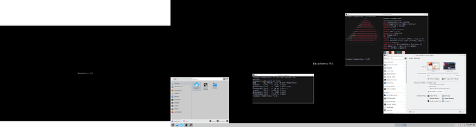

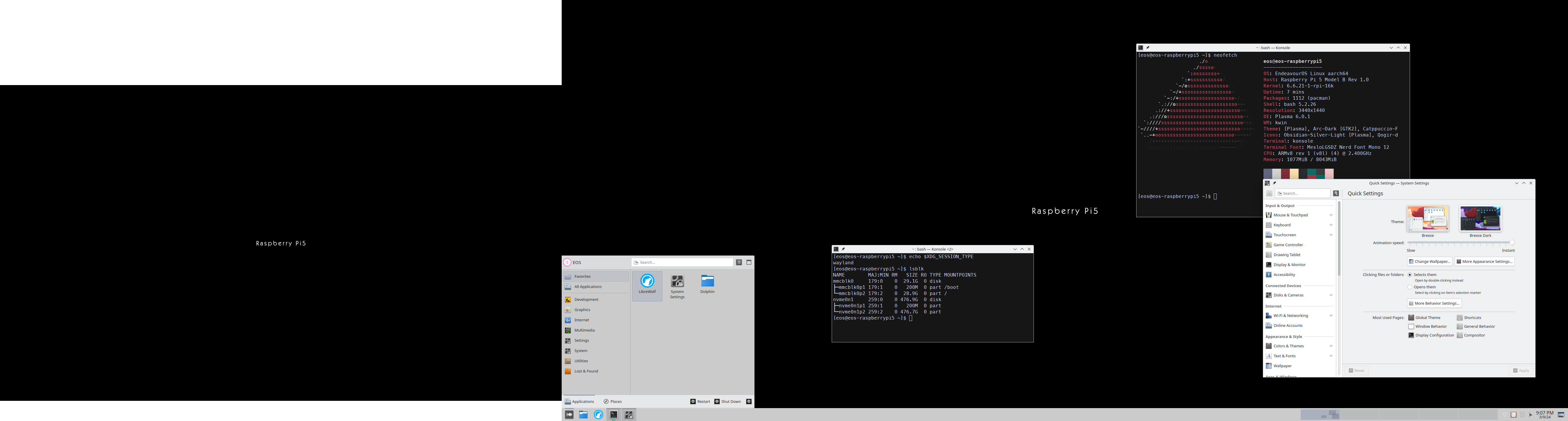

there we use plasma-desktop and plasma-workspace
Plasma 6 still have problem open X11 items
it boot on rpi 5 on wayland
